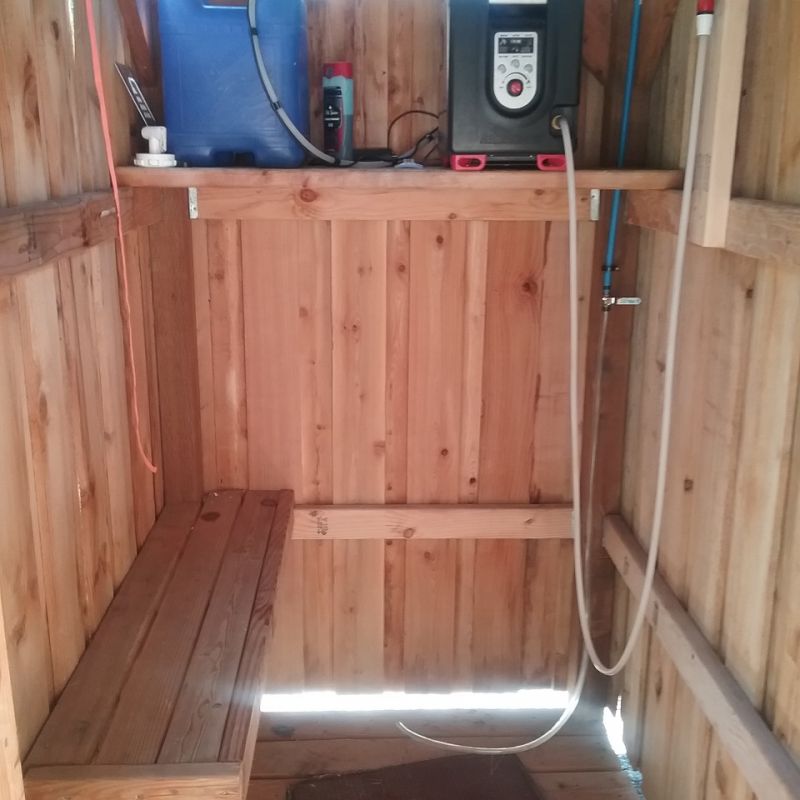

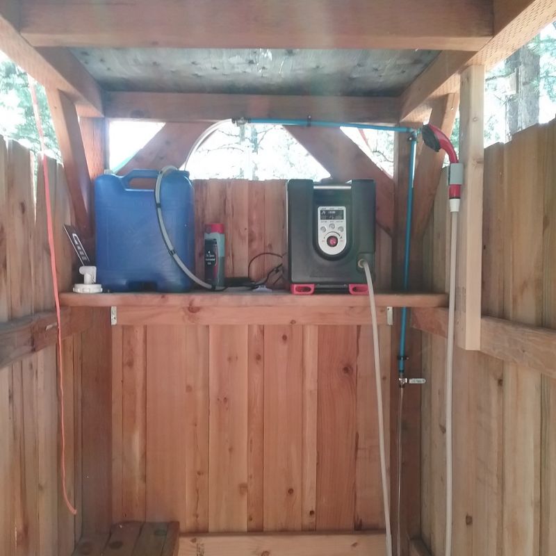

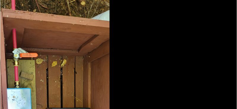

Jack, after so many days without a shower, one wants to go home. I too, installed a shower and everyday, a nice clean shower and feel like I just showed up to the cabin.![20220626_123643_resi.jpg 20220626_123643_resi.jpg](https://www.small-cabin.com/forum/shared_files/uploaded/11772/162849_1.jpg) 20220626_123643_resi.jpg
| ![20220626_123707.jpg 20220626_123707.jpg](https://www.small-cabin.com/forum/shared_files/uploaded/11772/162849_2.jpg) 20220626_123707.jpg
| ![20220626_123712.jpg 20220626_123712.jpg](https://www.small-cabin.com/forum/shared_files/uploaded/11772/162849_3.jpg) 20220626_123712.jpg

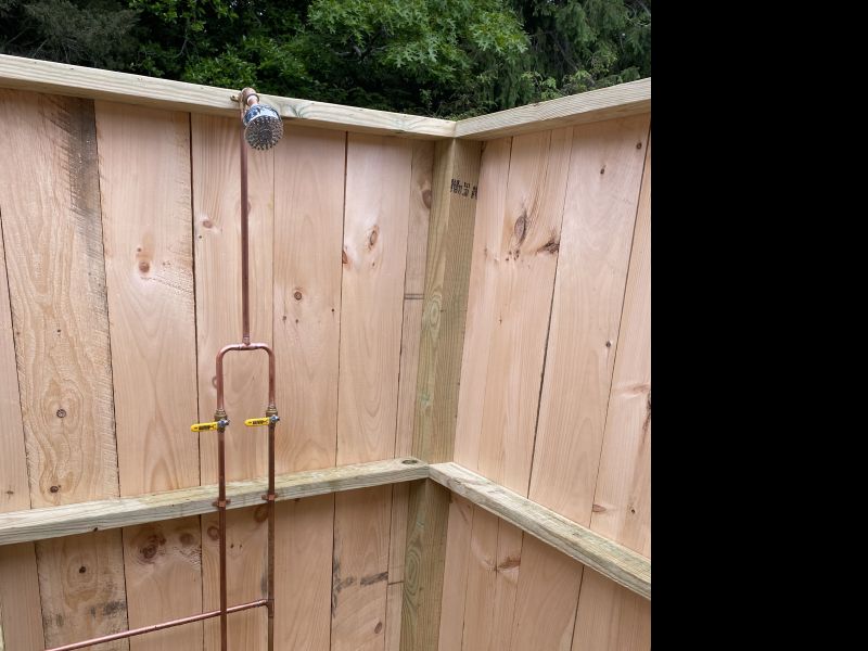

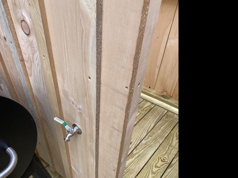

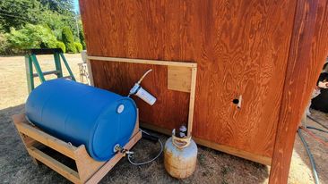

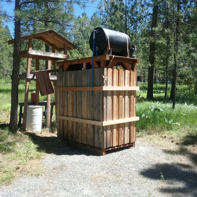

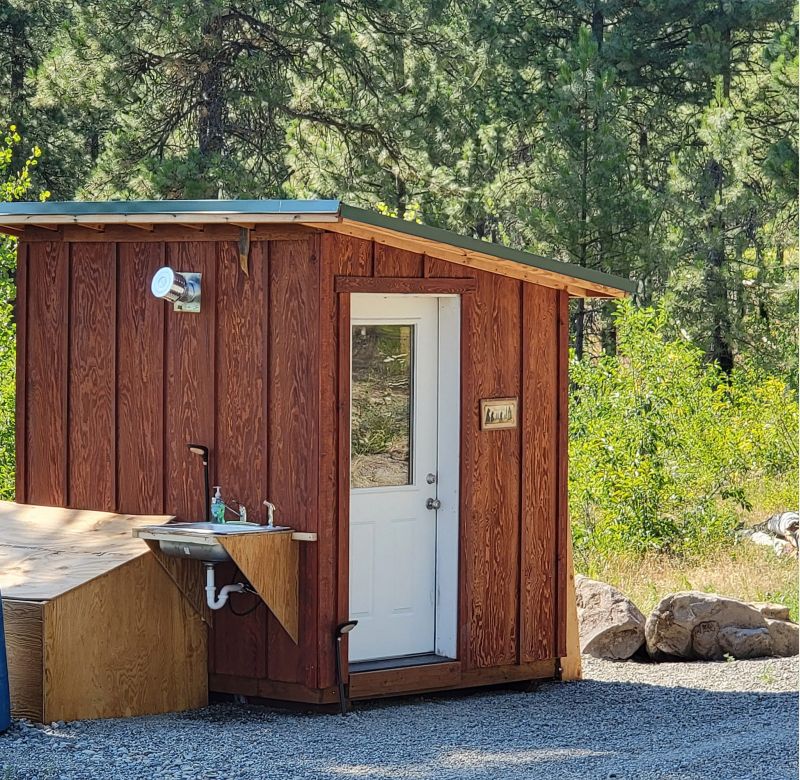

I pump water into the 55gal barrel when I get there, its run by a 12v pump, battery with a solar charger. The runs through the propane instant heater which is vented to the outside. I have it hooked to a switch and just last weekend plumbed in a sink.... its all run into a gray water drain field.![334198386_1530958257.jpg 334198386_1530958257.jpg](https://www.small-cabin.com/forum/shared_files/uploaded/11772/162890_1.jpg) 334198386_1530958257.jpg
| ![329749908_6094888543.jpg 329749908_6094888543.jpg](https://www.small-cabin.com/forum/shared_files/uploaded/11772/162890_2.jpg) 329749908_6094888543.jpg
| ![330035300_9296010418.jpg 330035300_9296010418.jpg](https://www.small-cabin.com/forum/shared_files/uploaded/11772/162890_3.jpg) 330035300_9296010418.jpg
| ![Shower.jpg Shower.jpg](https://www.small-cabin.com/forum/shared_files/uploaded/11772/162890_4.jpg) Shower.jpg

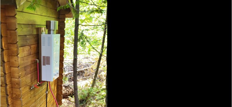

Whiskey, what brand/ model it your water heater?

Quoting: mj1angier Whiskey, what brand/ model it your water heater?
99% sure that is an Ecotemp L10 as I have the same one.

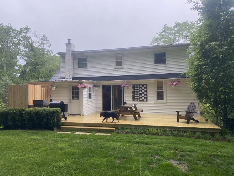

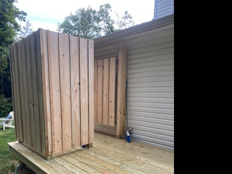

Since we are sharing outdoor showers…. We rebuilt our deck at home and incorporated an outdoor shower. I have wanted one since we moved in but there was always something else to that needed attention first. We live near the beach so it is working out great rinse off the sand, truth be told I haven’t taken a shower inside since we finished it over a month ago. I think I will set one up at the cabin as well.![B708AC37622441279.jpeg B708AC37622441279.jpeg](https://www.small-cabin.com/forum/shared_files/uploaded/11772/162908_1.jpg) B708AC37622441279.jpeg
