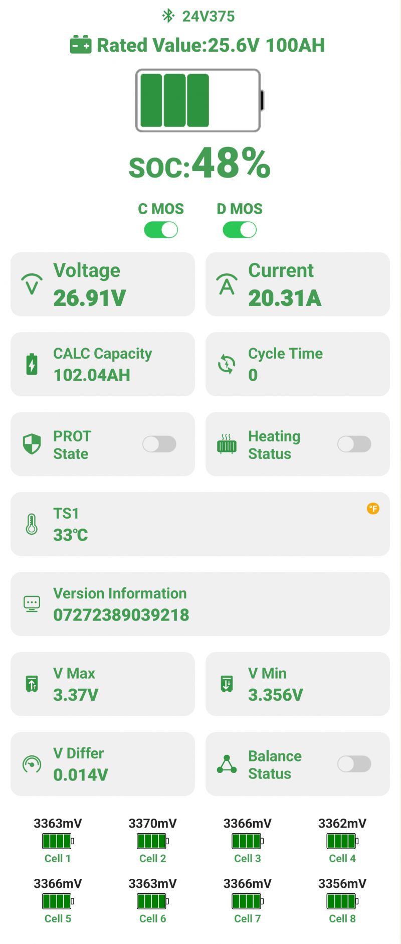

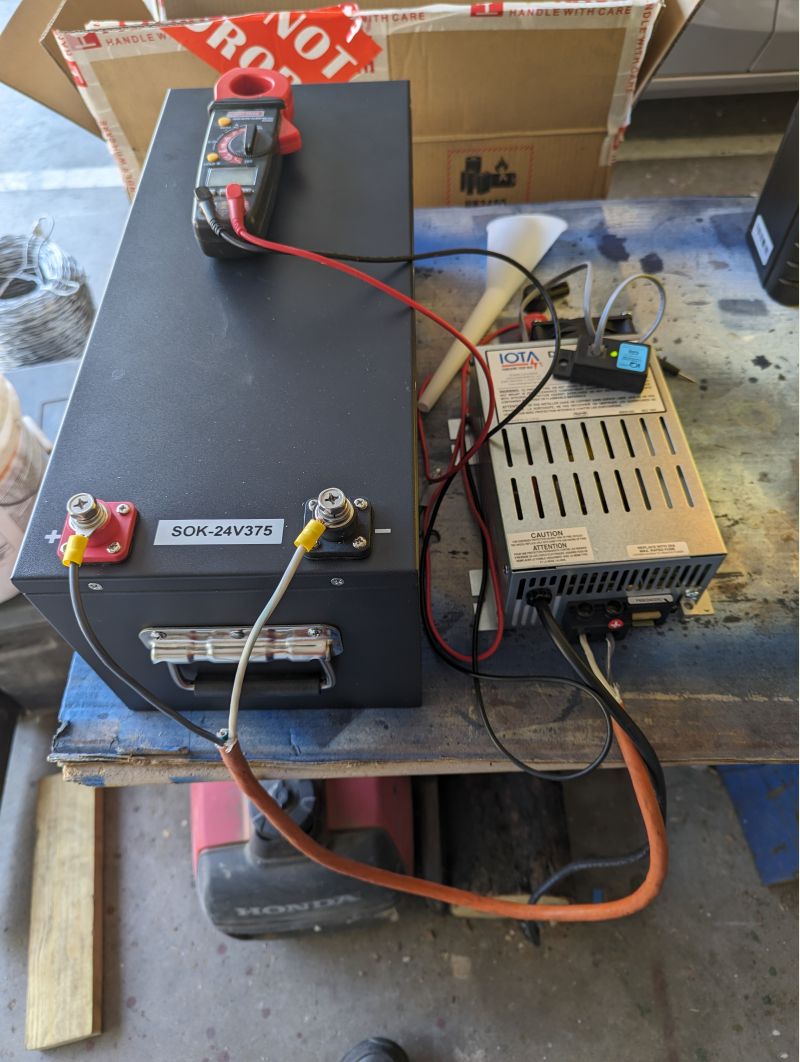

I have charged it at home and it will power the cabin as soon as I get back up there. The picture shows it on a bench with my 20 year old Iota 24 volt 25 amp charger. Iota has a new IQ module special for LFP batteries. Just plug it in and it's ready for LFP. The battery has Bluetooth and an app to use.

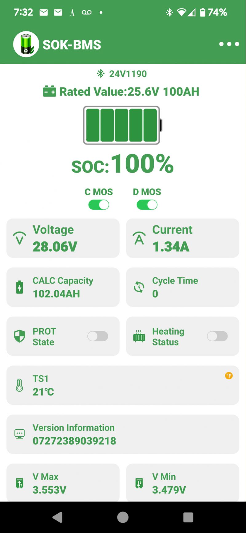

The SOK has been performing well. Charges quickly from the solar and it is very nice to have the BMS app on my phone.

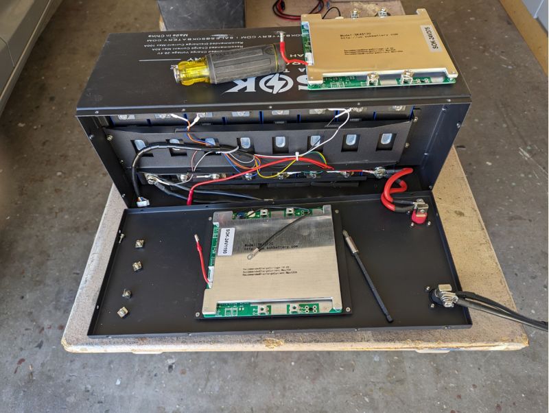

Min from SOK replied within a day. I was told they had encountered that potential [problem and had a BMS with revised firmware. All I had to do was supply a shipping address and they would send me a new BMS with the firmware changes. It arrived by FedEx in about a week.
I installed it today. It was an easy swap and works. That is another reason I was happy I bought the SOK. Many other brands are not serviceable as they are sealed cases.
Here's the battery on its side with the top removed. The new BMS is installed in the lid and the old one on the case.
sok 24
sok 24

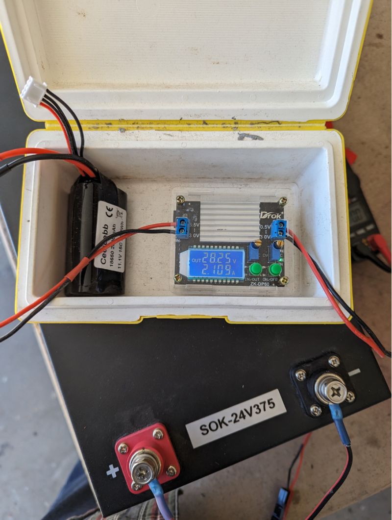

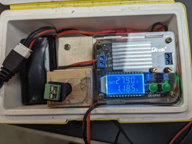

So I made a wakeup charger.
1. A DROK DC-DC buck-boost converter
2. An 11.1 volt Li-ion battery pack with a USB charger
3. Some wire, connectors and a switch
4. A small box
The 11.1 volts from the small battery pack is fed into the DROK converter. The DROK boosts the voltage to whatever you want (up to 30 volts). 28.8+ is a good charging voltage. The DROK can supply 2 amps easily and that is plenty to wakeup the BMS.
The output voltage is variable from less than 1 volt to 30 volts. The current is also adjustable up to about 4 amps. Even though the input voltage could be as low as 5.5 volts it performs with better reliability when the input voltage is at least 8 volts. I wanted something simple that could be recharged without any bulky charger or the need to remove cells and use a separate charger.
Once the BMS is awake and the battery warmed the solar can charge the battery.
Much better than lugging a fuel-burning generator when all I need is a wakeup.
I'll post another picture once I assemble everything in the box. (the white 4-pin connector on the battery is for the charger)
Might be useful to someone else....

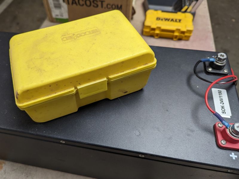

# Posted: 4 Oct 2023 10:12pm - Edited by: ICC

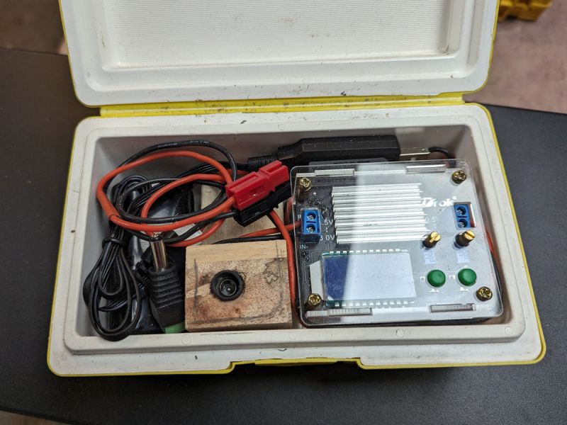

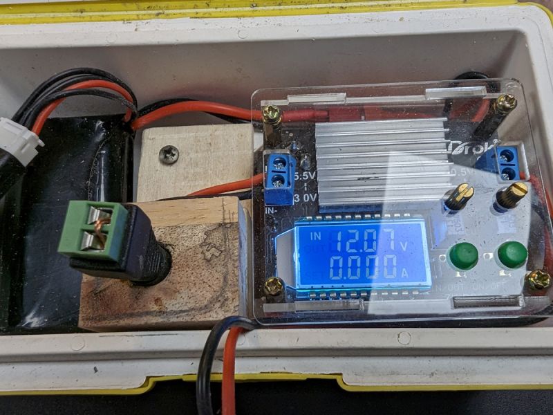

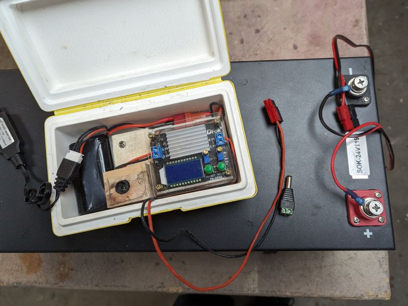

I assembled my little BMS "waker-upper" in a box.
The 3 cell battery power source is in the left end of the box. I used a DC barrel connector plug set instead of an on-off switch. Insert the plug and that completes the circuit. The box lid cannot be closed with the plug inserted, so the battery will be disconnected to close the lid.
So, connect the magic box to the andersen plugs from the battery. Insert the barrel plug to activate the dc-dc converter. Press the right-most green button the turn on the converter. Within 2 seconds the BMS wakes up. Remove the barrel plug to shut it down.
Please excuse the reflections of the ceiling panel lights
