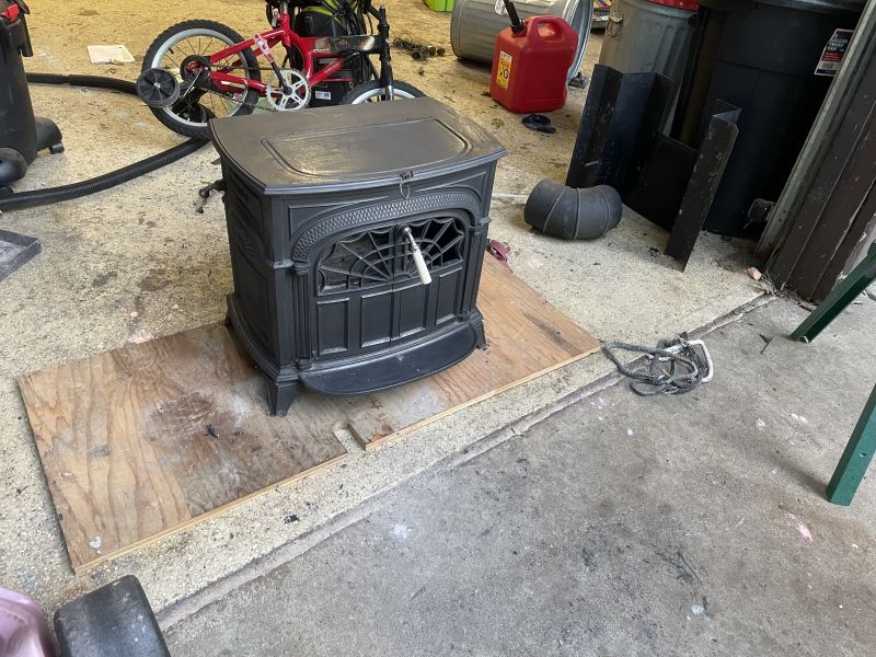

We have an el-cheapo wood stove right now that isn’t so great . I have to reconfigure the pipe/stack anyways since the snow messed up my chimney this last year, and fall is getting closer. I thought now would be a good time to look at getting an actual good stove.
We’re buying a used Vermont castings “intrepid” stove. Many of the new ones come with a Beautiful enamel-like colored coating.
Ours is a bit older, and is just cast iron and we’re considering painting it. It was sand blasted a couple of years ago, so should be just about ready if we want to paint.

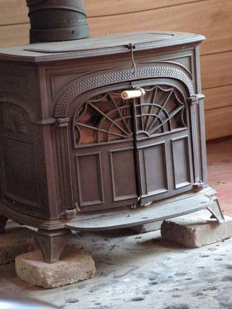

My VC defiant is stove polished. If done right it's a shiny almost graphite color gray/black. I had a ivory vigilant but it was to small and had lots of enamel chips. Most of the enamel stoves I see have lots of chips.

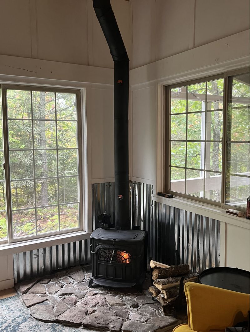

# Posted: 11 Sep 2023 03:06pm - Edited by: Grizzlyman
Well after deliberation- I wasn’t sold on any of the colors… so just decided to polish up with black stove polish. Turned out great and am very happy!
I spent a few hours rehabbing stove. Cleaning everything, putting new seals on all the seams, fixing the heat shield, thermostat, etc. looks like a brand new stove. Still waiting on ceramic handles as I broke them unfortunately.
Hooked up this weekend and just loved it. Amazing how much better a “good” stove is.
