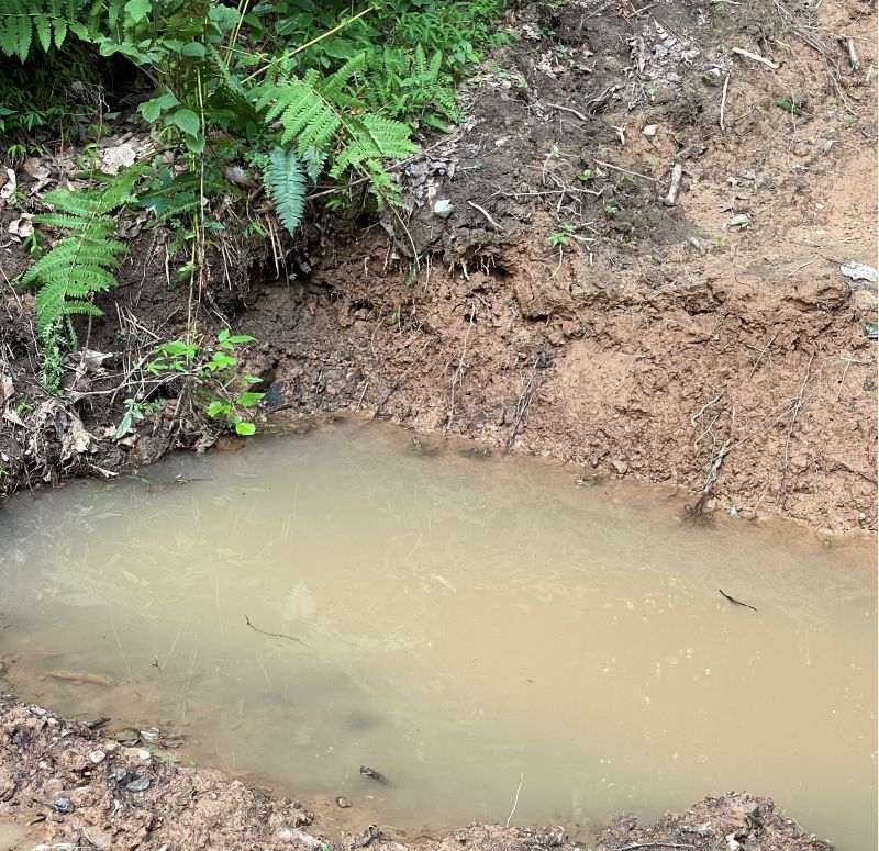

I have a seeping spring also. I did an initial dig with a tractor one foot down, three feet wide and six feet long to study the flow. The frogs are very happy. The trench stays full year round.
All these types of spring I have seen on youtube, they dig out the source to get the most flow possible. Then put in a spring box then pipe it down to a barrel. They then cover the dug out area to keep ground water out. I guess with clay. I haven't decided that part yet.

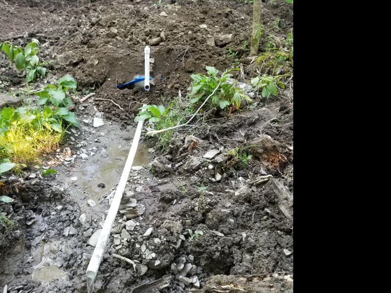

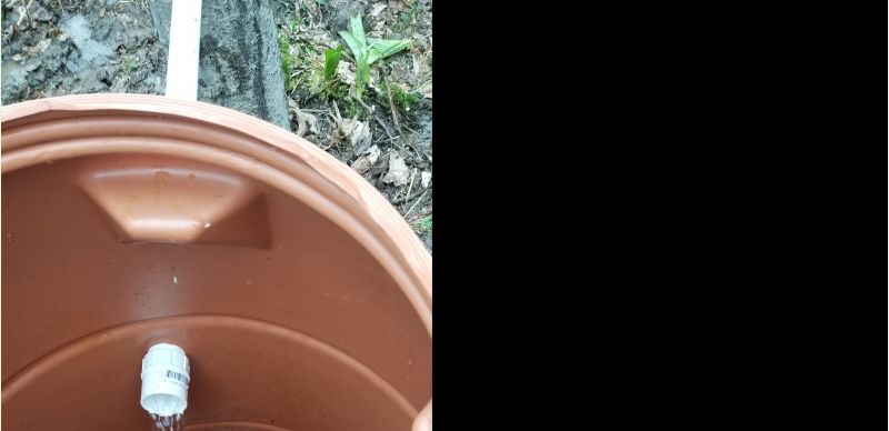

I found and improved a spring on my property and is our primary water source. Its seasonal but every spring I pump 500gal into holding tanks on a hill and never pump it again.
My spring head is a piece of U shaped stainless steel with two pipes coming out. One overflow and one supply to my spring box. My spring box is the brown 55gal drum. The pipe with the holes goes to my pump and the other is a overflow. I also have a overflow in the pipe between the spring box and spring head.
Having overflows in the system is very important because if things get clogged your spring water can go around your spring head making all that work for nothing.
My pump is just a 120v 1/2hp jet pump that pumps about 60ft vertical. To pump 500gal it takes about 1hr through 1in black poly.
