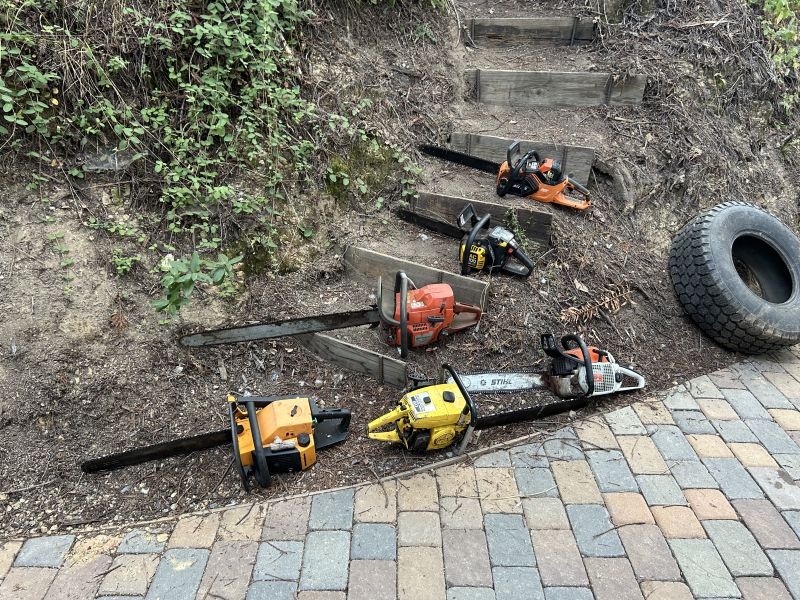

# Posted: 19 Aug 2023 10:04pm

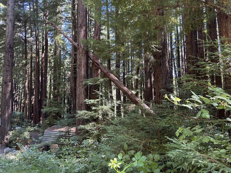

Last week I took down this halfway fallen tree that was threatening the shed below it. For the last few years I have been using an 80v lithium saw, no big cutting though. This job gave me the opportunity to drag out all my old 2 stroke saws for a revisit . Put fresh fuel in (I had stored them dry) and fired them up outside the cabin for testing. Started and ran fine but once down at the tree they wouldn’t restart once warm. No amount of pulling, choking, starter fluid would help. Hmm. Next morning back at the cabin, back to working again cold.
Finally got the job done using the 80v, but it would only do 1-2 cuts between charges, and I only have one battery.
So what’s with the old saws? Weak ignition once hot? Bad internal seals? Modern ethanol fuel?
My neighbor kid is hot on these new fangled fuel injected chainsaws. Is that what it takes now?
# Posted: 20 Aug 2023 04:27am
Ethanol from pump gas ate up my Stihl 440 Magnum carburetor. I use Stihl gas now.
rpe
# Posted: 20 Aug 2023 07:39am
We've got a collection of old saws as well, and they do need attention to stay operating well. Majority of the time issues are fuel related - usually gummed up/contaminated carb. Not sure about your hot-start issues - this was just with one saw, or same symptom on multiple? Low compression could cause that symptom of hard hot-start. Also check and clean out muffler. If it's been sitting for a while, and then run hard, carbon deposits might have flaked off and plugged the muffler exit.
Electric saws are handy for small jobs, but nothing beats the power of the 2-stroke on bigger jobs. Our biggest saw is the Stihl 088 my son and I rebuilt from box of parts. Big 'No Wimps' sticker on the side.
# Posted: 20 Aug 2023 04:22pm
Thanks guys. So this morning at the cabin, both Macs fired right up, and the Monkey Wards, whatever that is. The Stihl and the Husky wouldn’t and upon pulling the plugs I couldn’t detect spark, though they both gave me a slight jolt. I’ll try new plugs.
I still have to buck that tree so more chainsaw fun next week.

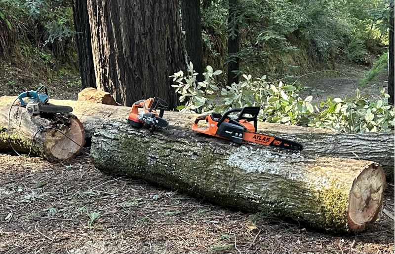

# Posted: 20 Mar 2024 09:40am
Pretty fair chainsaw day yesterday. Had this dead trunk blocking the driveway. My gas Stihl and Mac are still down, so the 80v Li did the bulk. When that died, late and no time for a recharge, I grabbed the little B&D 40v I just bought new pre-Li batteries for (Mcad or whatever). Went through both of those with only one cut, no comparison to the Li. Had a genny running charging the 80v, and an old corded 110 ac saw kicking around so I drug a cord over and finished with that and got the road cleared.
Parts arrived for the Mac, will finish the bucking with that. The Li saw is good for initial take down and clearing, gas for repeated cuts.

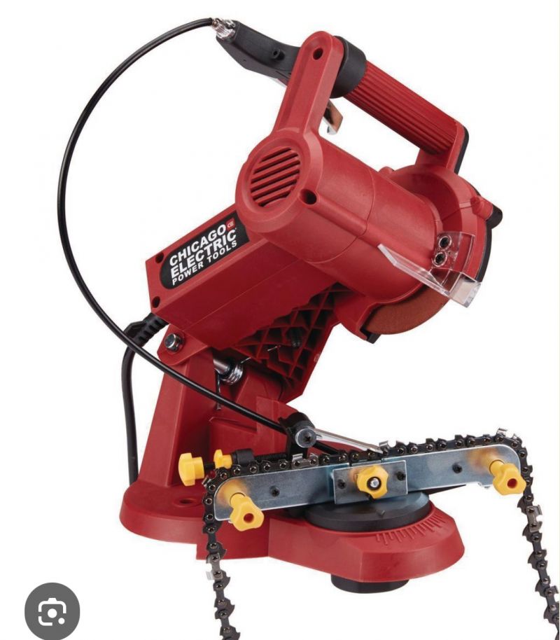

# Posted: 29 Jun 2024 02:07pm
Kept getting my saw bar stuck mid cut yesterday. Thought maybe it was dampness in the recently cut logs I was bucking, even looked it up and there are some complaints about that. But I got out my sharpener, one of those bench mounted, carbide wheel adjustable angle jobs, and the fresh sharpening made all the difference, even though it was cutting OK before, at least until it got stuck. Lesson learned.
# Posted: 29 Jun 2024 02:28pm
They all benefit from sharp chains but the light duty saws Really Need it.

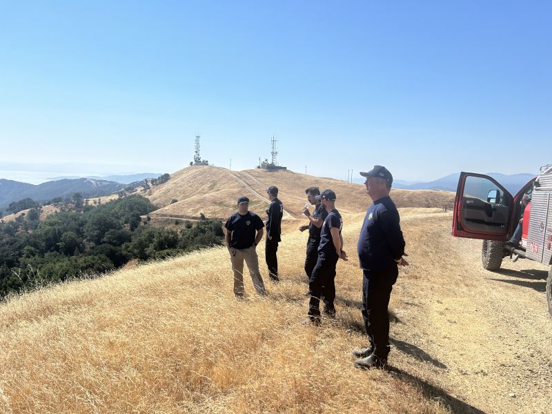

I did get to go with the FD yesterday on a fire road check up the hill to some cell towers. Fun morning.

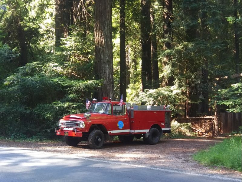

That’s what we have now, 20something F550 4x4, I think it’s only 300 gallon. Back when I was active, I responded in this old guy, which I’ve posted here a thousand times, as when it was finally retired they gave it to me. It still runs and pumps, I park it at the gate on the weekends and take it to community functions etc. What a difference driving that beast, carbureted, no power steering, granny low stick.. compared to the new one a kid could handle.

Neat old truck
Do you keep it full for emergencies?
# Posted: 21 Jul 2024 08:08pm
I do keep it full. Two things at the moment though: One, I had to drain it to fix that rear flat mentioned last month, floor jack wouldn’t lift it full. I’ll refill next time I fire up the well pump. Second, the pump engine, an old V-twin Tecumseh, takes its own 12v auto battery (E start). You know me and batteries, it’s all I can do to keep a battery in it to drive the truck. One of these days I’ll run a cable back from under the hood so I can run it all off one batt.
But yeah, my dream is that one of these days we’ll get a fire call, and the new rigs won’t run because of some computer glitch, and I’ll be at the rescue in the Inter.
# Posted: 21 Jul 2024 09:31pm
Mid to late 60s? Cool gift.
# Posted: 21 Jul 2024 10:44pm
67. And it’s only mine while I’m here. Still has the exempt plates and is titled to the FD. I was just the last guy who really used it. There are a couple of young gear heads in the department now, hopefully when I’m done one of them will want it.

Ok back to saws. I guess the E saws do run slower, never really paid attention. And for sharpening, I use the sharpener pictured above, and always at 35 degrees. Never played around with less angle. Depth of cut is pretty much determined by the height of the depth things in front of the cutters afaik.

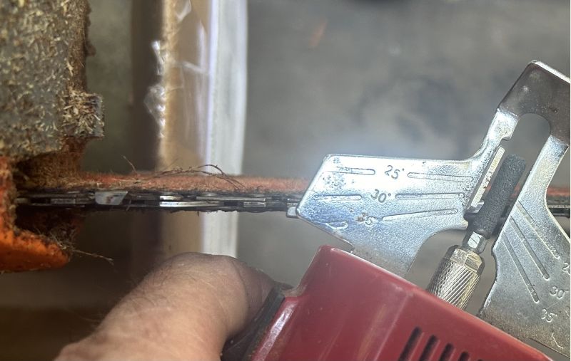

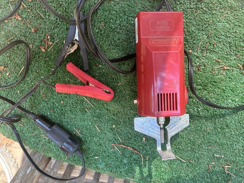

My old neighbor (the guy that moved to Madison) called me to come over after his yard sale and take anything left. Like I needed more junk, but in the pile was this hand held chain sharpener by Oregon. I remember some other bits with it but still sorting through the stuff. Haven’t tried it, must be easier than pulling the chain like I do now.
# Posted: 23 Jul 2024 12:49am
I've got one like that on a Dremel.
Works quick and easy. I just try to not over grind it. Same way with the bench mounted one like you have.
# Posted: 23 Jul 2024 01:20am
I have one pretty much like that Paul!
I think I decided it needs a different diameter stone for my size chain.....I think....
Things got kinda jumbled in my head after my heart stopped last Jan 6. Im still sorting out my projects but also taking more time to just putter and enjoy the new cabin delivered May 1. I haven't run a chain saw since last year, for the smallish jobs I just grab the cordless recip-saw with a coarse wood blade.
# Posted: 23 Jul 2024 09:06pm
Boy this is slick! Sure beats pulling the chain off. Can’t find the other bits too though, might have forgot them at the yard sale.
One thing, when I use the bench sharpener, I put a clothes clip on the chain so I know where I’m at. With this I’ll just mark the start tooth with a red marker.
