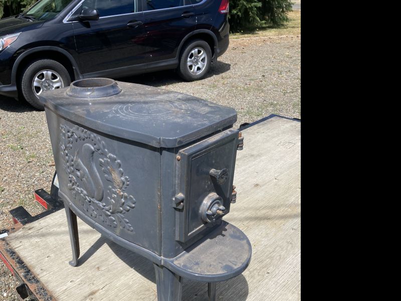

I was given an old Morso. I think it’s a 2b either classic or standard.
The ID of the flue collar is 4-3/4”. So a 4” or 6” stove pipe won’t fit without an adaptor which I do not think is made any more.
The people at the stove shop said the model has changed and new parts from Morso may not fit.
Any ideas on how to connect this stove to either 4” or 6” pipe?
Thanks!

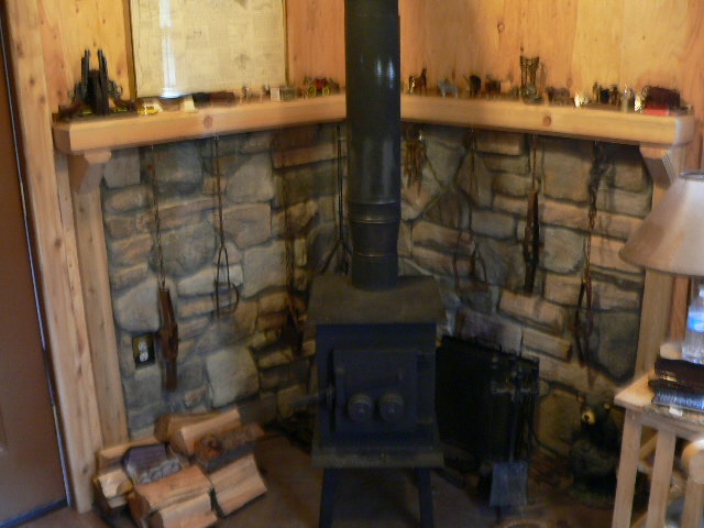

# Posted: 28 Aug 2023 08:07am
Mine uses a 5" pipe, I have an adapter to 6" pipe on it.
