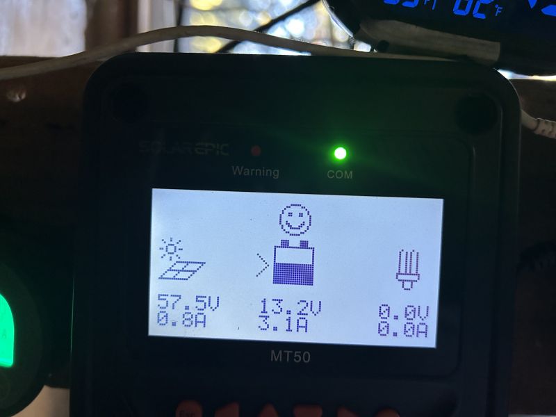

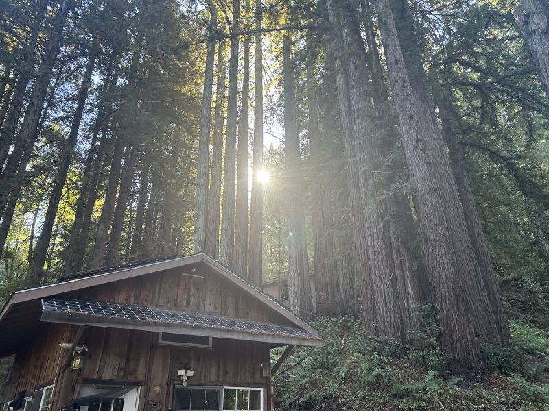

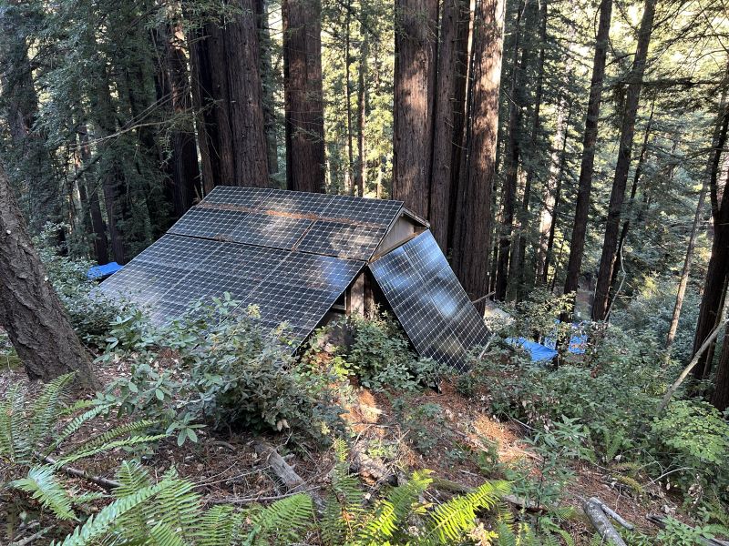

Combo. Just took these photos, 1pm sunny day. First from the cabin looking south west. 3 panels on overhang above door, 3 more on roof. Bulk are on the shed visible above and uphill. Some face south, most west. As I said in an hour there may be a few more in the sun but it won’t last very long. Epever says 60 volts 3 amps to bank.
# Posted: 11 Nov 2023 04:49pm
Im amazed that you have done as well as you do under those conditions, Paul. Lot to be said for the way you have balanced your loads and over-paneled enough to keep up.

Holy crap on a cracker.. That is one tough solar environment. I'm definitely not suggesting you cut any of those beautiful trees.
If you have some money to burn, maybe switch to a Victron and see if there is any difference for you. You can also keep the Epever as backup! I think you would see a difference. Plus you could do an easy Arduino project to throw the data up in the cloud. That may help you optimize things (although I'm not sure what the heck you could optimize in those conditions). At the very least you will have cool graphs to look at ;)
Otherwise just keep plugging along with what you have. It seems to be working for you.
