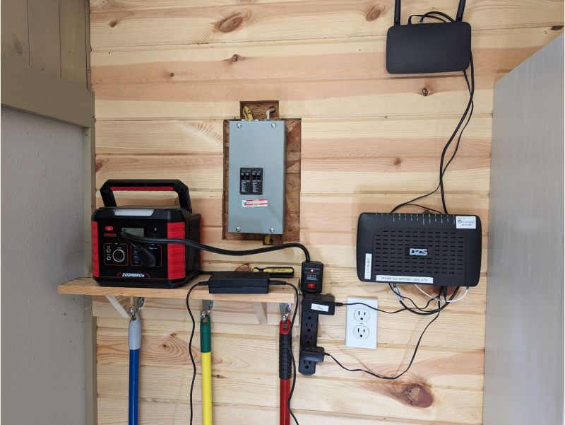

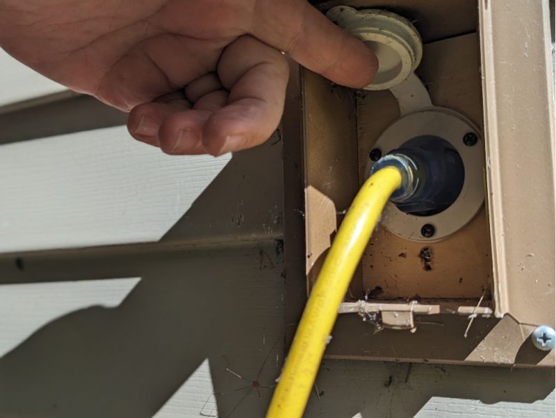

A small subpanel box and a couple of breakers should be under $40 (US). I just used a marine shore power connector on the outside wall to connect the 2000w generator with an extension cord. (The picture may look a bit odd as I am off the electric grid, but I have a fibre internet connection in the cabin.)
Inside
Inside
Outside
Outside
