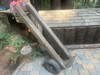

I use plugs too, provided the puncture is large enough to get the rasp through. But the Slime is holding so far on my home made, off road, tube tired hand truck!

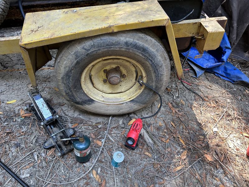

# Posted: 21 Sep 2023 08:00pm
Quoting: darz5150
I am sure most of you remember the starting fluid and flame method. Lol🔥
Ha, funny you mention that! One of my projects today was getting my old log splitter going. This tire was dead flat, evidence by the dirt at bottom, and the bead was off the rim half an inch. I hadn’t done the starter fluid trick in many years and was plenty worried about starting an inferno but I’ll tell ya, worked first try.

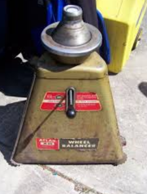

Remember the bubble balancer?
Balancer
Balancer

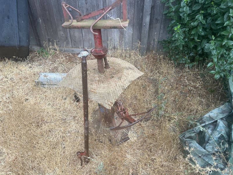

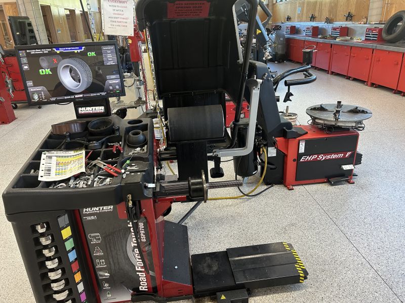

# Posted: 22 Oct 2023 11:56am
I still have a manual machine and bubble balancer, still get occasional use for tractors and stuff. But for good wheels I use the modern hi tech equipment at my local college where I still take auto classes.
# Posted: 28 Oct 2023 11:52am
Paulz, that old manual tire machine, I knew an old timer who had one and he let us use it all the time. That new one is the exact unit we have at work. I mean identical.
