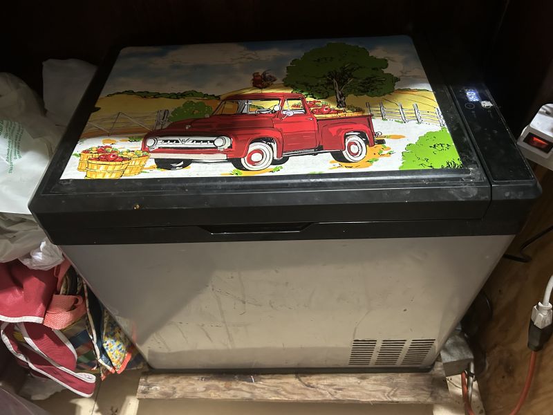

I’ve had this 12v RV fridge for several years. Been very reliable and not too amp consuming but it’s been on almost constant lately, sometimes leave it on for a day or two when gone instead of repacking the food.
