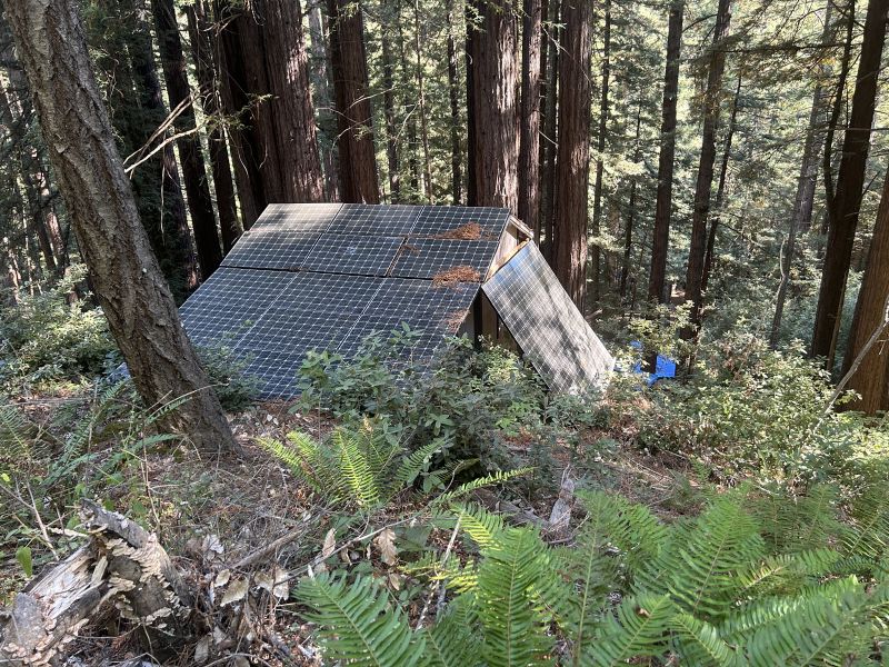

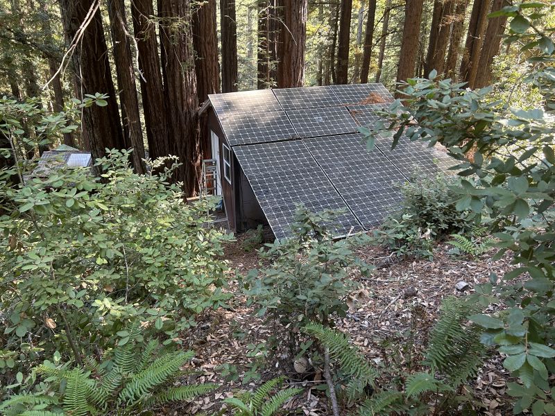

My solar took a huge leap forward about two years ago. I got wind of a homeowner in a nearby town who bought out his solar lease, went back on the grid and gave me everything. Still got two grid tie inverters with no need.
I put 24 of the 260 watt panels on a shed I built with extra lumber awhile ago. 6 more panels are on the cabin roof (just visible below in photo). They’re all MC4s. They’re getting to be old now but I recently took one down, washed and tested in full sun and it still put out close to advertised amp.
I’m way over paneled but in my shaded woods, no more than a handful are ever in direct sun, about 50 amps is the most charge I have ever seen (my generator powered charger will do 80) IMG_1573.jpeg
