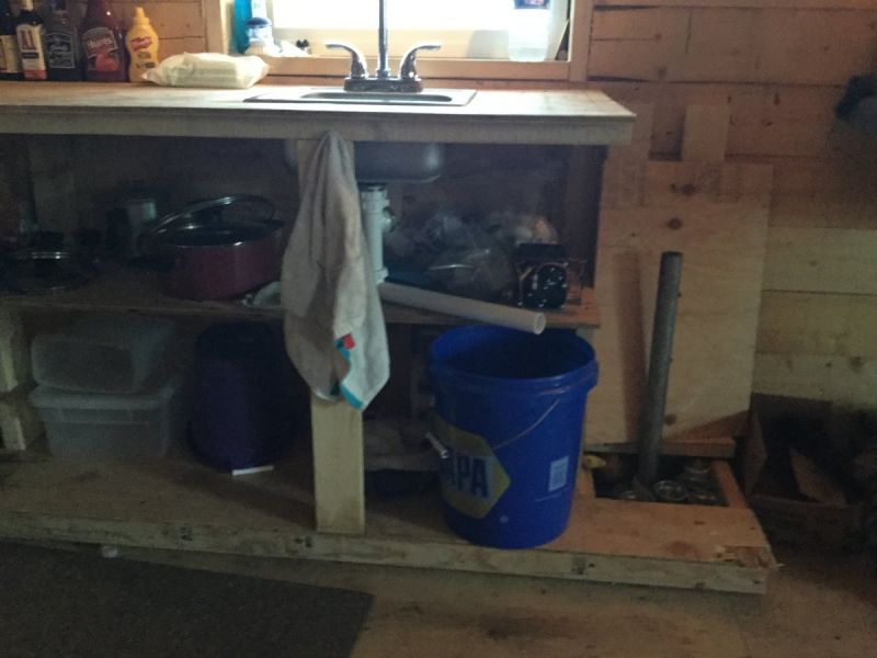

how will you pull water from the sand point well?
# Posted: 11 Oct 2023 09:21am
We have a 12v lift pump. Cost was about 75 bucks. Will set underneath the counter and running a suction hose down the well pipe. The lift pump has a built in pressure switch. So we can hook up to the kitchen sink directly. Then if you want water just turn the faucet on. They also make submersible pumps that are 1-7/8" diameter so it fits down a 2" pipe.
