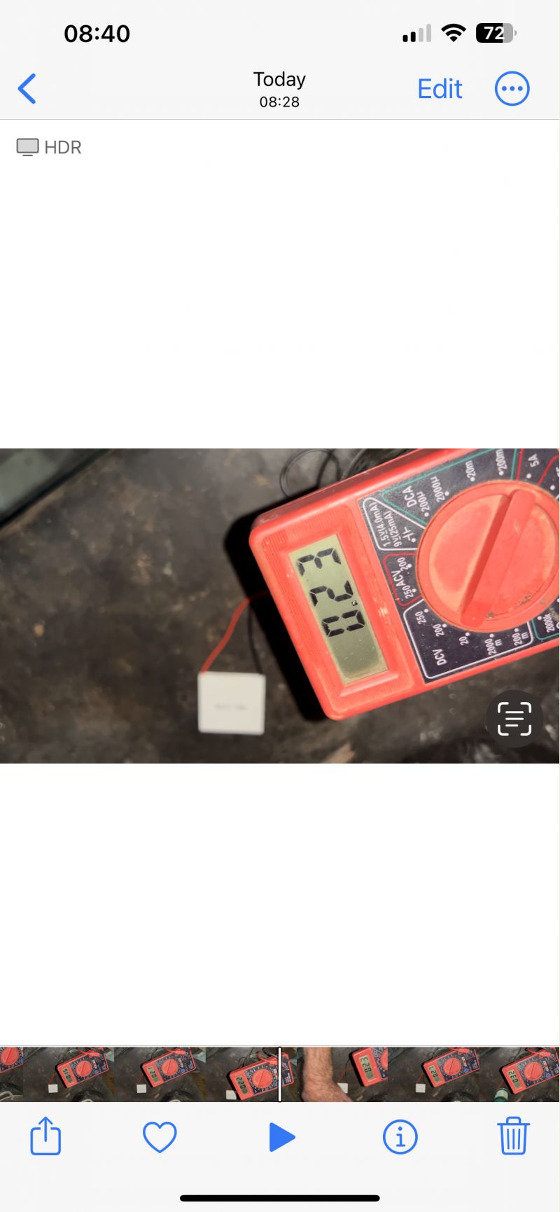

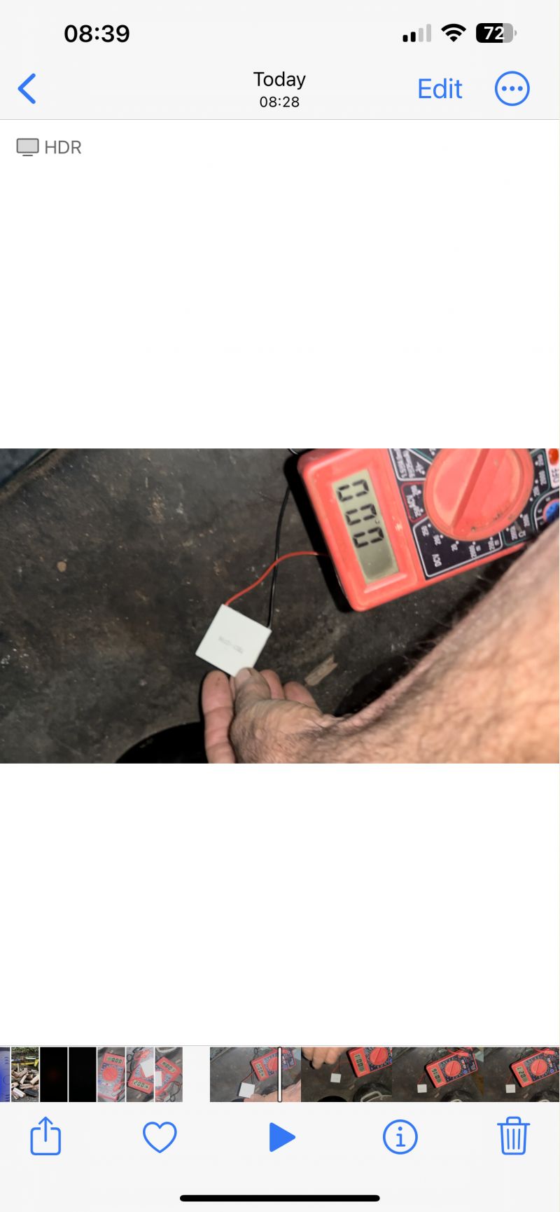

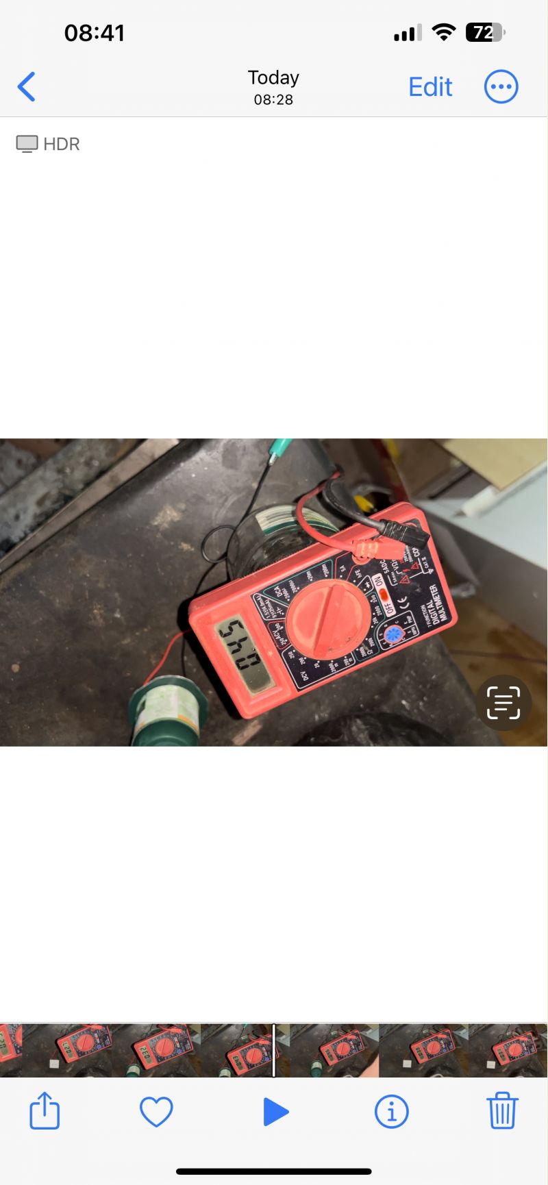

# Posted: 25 Oct 2023 11:38am
Got a $8 TEG in the mail. See if this video I took works.
# Posted: 25 Oct 2023 11:50am
Guess it wouldn’t accept it. Here’s the gist
Set it on my wood stove at 00
Went to about 1/4 volt
Set pudding cup out of fridge on it
Almost 1/2 volt!
Amperage unknown..
Might have to buy 500. Chimney will look like a decorated Christmas tree this winter!

Two more things Nobs; first thing I had to do since it’s not marked for sides was hook a small battery to it. One side got very hot immediately, other stayed cool. Useful hand warmer..
I also tried it with one tiny LED light on the wood stove. Nothing. Hooked my ammeters up to it, .002 amps.
Guess I’m about done playing with this thing, going in the spare junk box..
