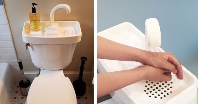

# Posted: 13 Oct 2023 11:10am
I'm not sure if would work for your scenario but the Japanese have toilets with a sink integrated into the tank. They sell various kits on Amazon.
https://www.amazon.ca/Sink-Twice-Glacier-piece-flush/dp/B074KNYT46
Toilet Sink
Toilet Sink

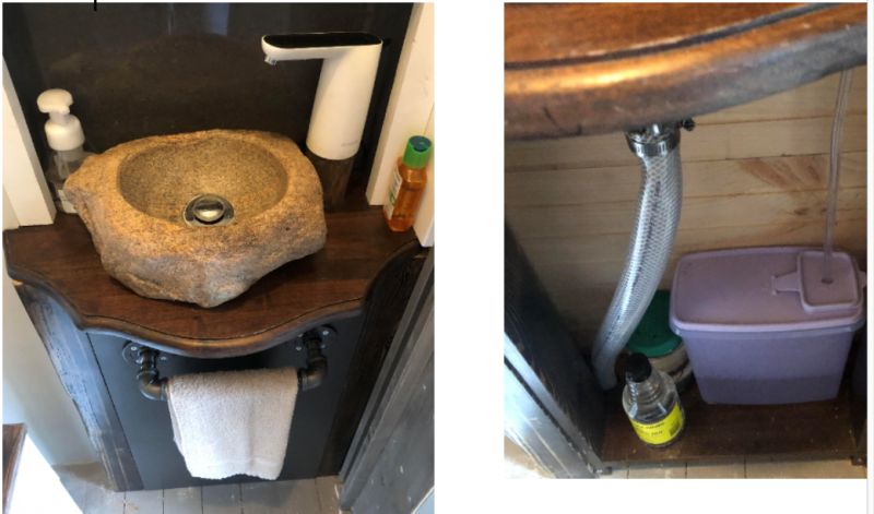

# Posted: 13 Oct 2023 01:00pm - Edited by: KelVarnsen
Here's a picture of my sink setup in my tiny cottage bathroom. We've been using USB rechargeable water dispenser pumps and just filling a container under the sink with water to pump out of. For toothbrushing and hand washing it does the job. They are dirt cheap and pretty reliable.
