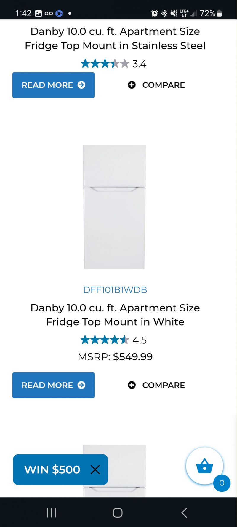

Help me understand what the peak watts are for this model refrigerator. I was able to get so info from the manufacturer.
Refrigerator model
Refrigerator model
Manufacturer email
Manufacturer email

If you take the Max starting amps quoted in the picture, 11.9A TIMES 120V = 1428W.. Doubtful as that is insane.
So if you take the times 3 they quoted 3.9A TIMES 120V = 468W.. Probably more realistic for a starting draw (for like 1 second)
Fridges run about %50 of the time so you are looking at 70W (I'm trusting their numbers) TIMES 12H = 840Wh/day. If a solar system is big enough to power the fridge during the day and you start the evening with a full battery than you will need a battery bank of about 420Wh to carry that fridge over the night.
