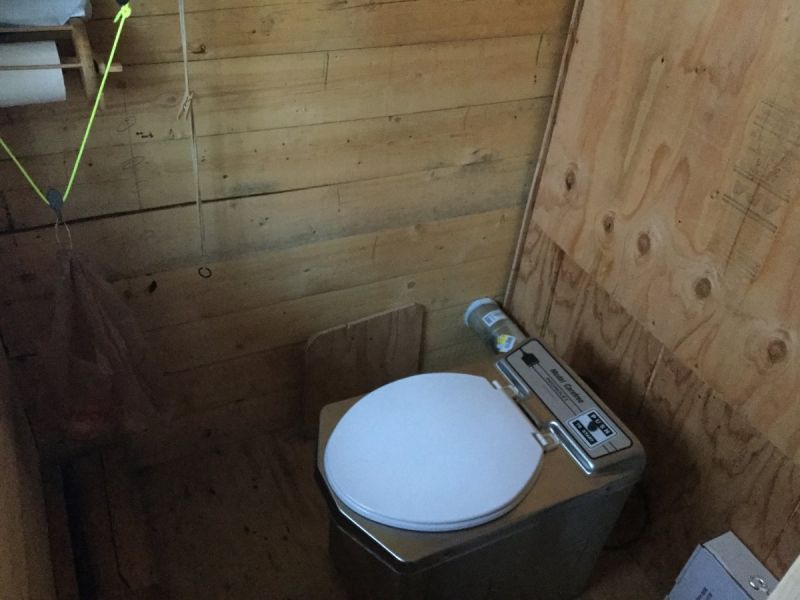

We have an Incinolet incinerator toilet. 30 amp electric. No odors. None. They are fairly simple with not many components so I wouldn't imagine much for problems.
I believe that Incinolet is made in America. So parts or service would be good. Very easy to plumb. 4" abs pipe and a rubber collar attaches it to a vent outside similar to m a dryer vent. For the electrical I uses 10 guage underground wire and ran it from a 30 amp receptacle to a 30 amp plug in that connects to our 2500w duel fuel champion generator. Very easy. We charge up the batteries on everything n get the freezer down to temperature while burning the poo.
It is a nice addition to the cabin. When I am by myself I just open the flapper doors and put a bunch of heavy duty garbage bags in it. When done remove the bag n burn or dispose in a garbage can. I would recommend them to anyone with a cabin without septic system. Especially where it gets really cold outside. And my beautiful wife has foot issues making walking difficult. So yes I'd recommend them

Our Incinolet takes 40 minutes to burn. And yes new liners are used for each cycle. It burns urine also. Yes 2 deposits can be made. I just put some extra toilet paper over the first deposit or a paper towel to cover it up. We do not leave piles of poo in it.
The odors are not bad. Actually the only odors are the deposits, also have a window in the bathroom if needed. And for me, better than cleaning a compost toilet. Just push the flapper making up,then bowl part so it drops into the incinerator n push the button.
I would highly recommend them. We like to use our cabin year round and using an outhouse at below zero in not good.
I do not understand why folks seem to downplay how well they work. It is a very good design and works great. And certainly cheaper than installing holding tanks that need continued servicing or installing a septic system. And have been used on boats for many years.
It makes using the cabin a 4 season cabin. If you had grid power, absolutely no problems. A box of liners is cheap n lasts years.
