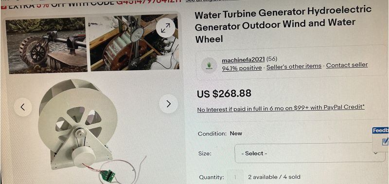

Saw this on eBay. Only 100 watts. Wouldn’t mind trying it in the creek, don’t know about a $300 gamble. I do have car alternators..
# Posted: 20 Nov 2023 02:57pm
Wonder how those little windplant gens would work on water drive?
