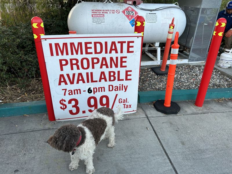

# Posted: 26 Nov 2023 11:27pm - Edited by: paulz
Had 5 tanks refilled today at the gas station. $73, $77 with tax. 22 gallons (had to take his word but they were all empty). Sign says $3.99 but i have a membership card, paid $3.50. So that’s about 4.4 gallons per tank, he did loosen the screws until gas came out.
Would have been $110 for exchanges at Ace Hardware.
Thanks for all the input.

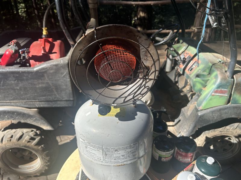

Here's a reverse question:
My pal that frequents the recycle yard is still giving me full Coleman bottles. I don't know why people keep getting rid of them, but I now have over a dozen kicking around. Only use one to start the wood stove or bbq, and can refill from a 20lb. tank with the adapter so I only need a couple.
20lb. tanks do the bulk; hot water, generator, stove top, bbq..So, can I fill an empty tank using full Colemans? Just have the empty tank upright? Do I open the bleeder and empty completely first?

You can buy an adapter to fit a disposable 1 lb cylinder onto a OPD connector

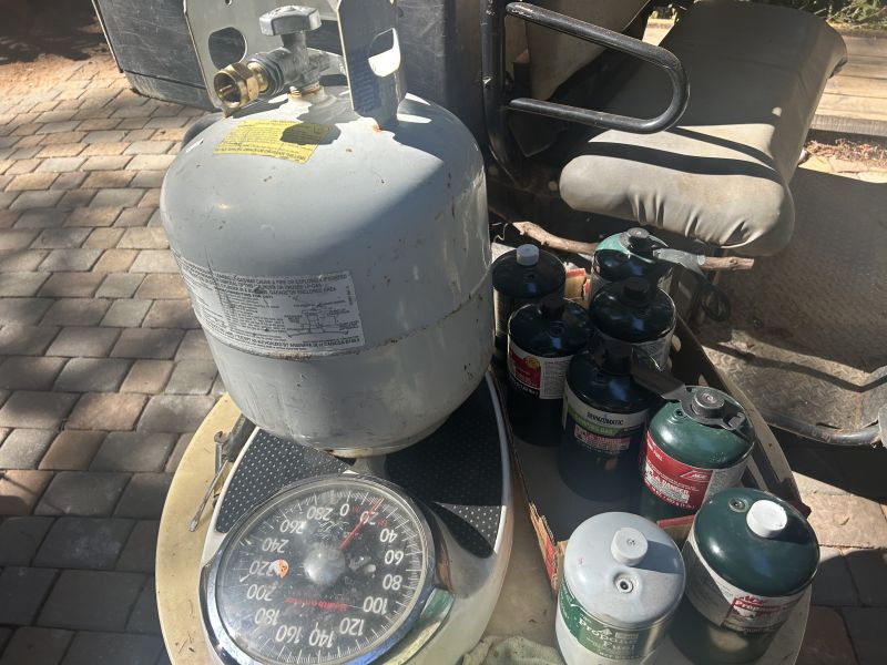

# Posted: 13 Aug 2024 12:32am
Quoting: ICC
Got that, it’s what I use to refill the Coleman’s.
Ok, success. I grabbed a dead 20#er, cracked the bleeder to be sure, nothing. Put it on a scale, about 18. Emptied 3 new Colemans, weight went up to about 20. Better yet, it works! Got about a dozen more to go.
