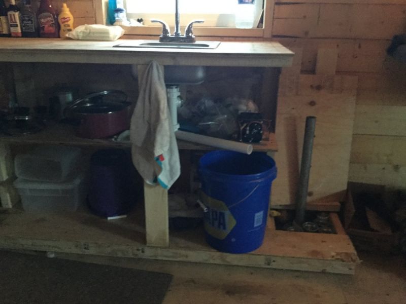

I have a 2" sand point well started in our cabin. Just need to get an electric jack hammer to finish. The well drilling company that I bought the sand point from told me these tips.
First I bought the best point I could. 4' stainless steel. 5 micron holes if I remember correctly. Cost me 500 $. Pour water down the pipe while drilling. When the water drains out you found the water table. Use air pressure to blow mud from the outside surface of the point. To clean it. I have a lift pump, sur flow I believe. That should lift up to 25'. With another 5 micron basket filter just before it enters the pump. This is with a garden hose, with a 1/2" hose. I have some 3/8" tubing on hand in case I need more lift. The 12v pump has a built in pressure switch, 40-60 psi. So it could be hooked up to the kitchen sink.
There is also a push pump that is 1-7/8" diameter that will drop down the pipe available to purchase. If I needed more lift I was looking to add that pump to the lift.
To make a driver I have a 2" to 1" bell reducer and a 12" long 1" pipe on top. I will weld a piece of 1-1/4" pipe that will slide over the 1" and make an adapter sleeve that the jack hammer driver will fit into.
Also if you weren't aware. You can use standard 2" galvanized water pipe for the casing . And there are special couplers that allow the pipe ends to match up to each other for installing them for a well casing. Well casing couplers so that the threads of the couplers don't have to take the force. I just had the well folks supply those along with the sand point. And bought 2" pipe from H D. I have the well inside so it fits under the kitchen counter top. And will be inside the kitchen cabinets. On the end so I can take the end piece off n service the pump n filter. And 12v battery that will run the pump.
I should be able to get fresh potable water right from the kitchen sink faucet.
I have a picture of the pipe started.
Well pipe
Well pipe
