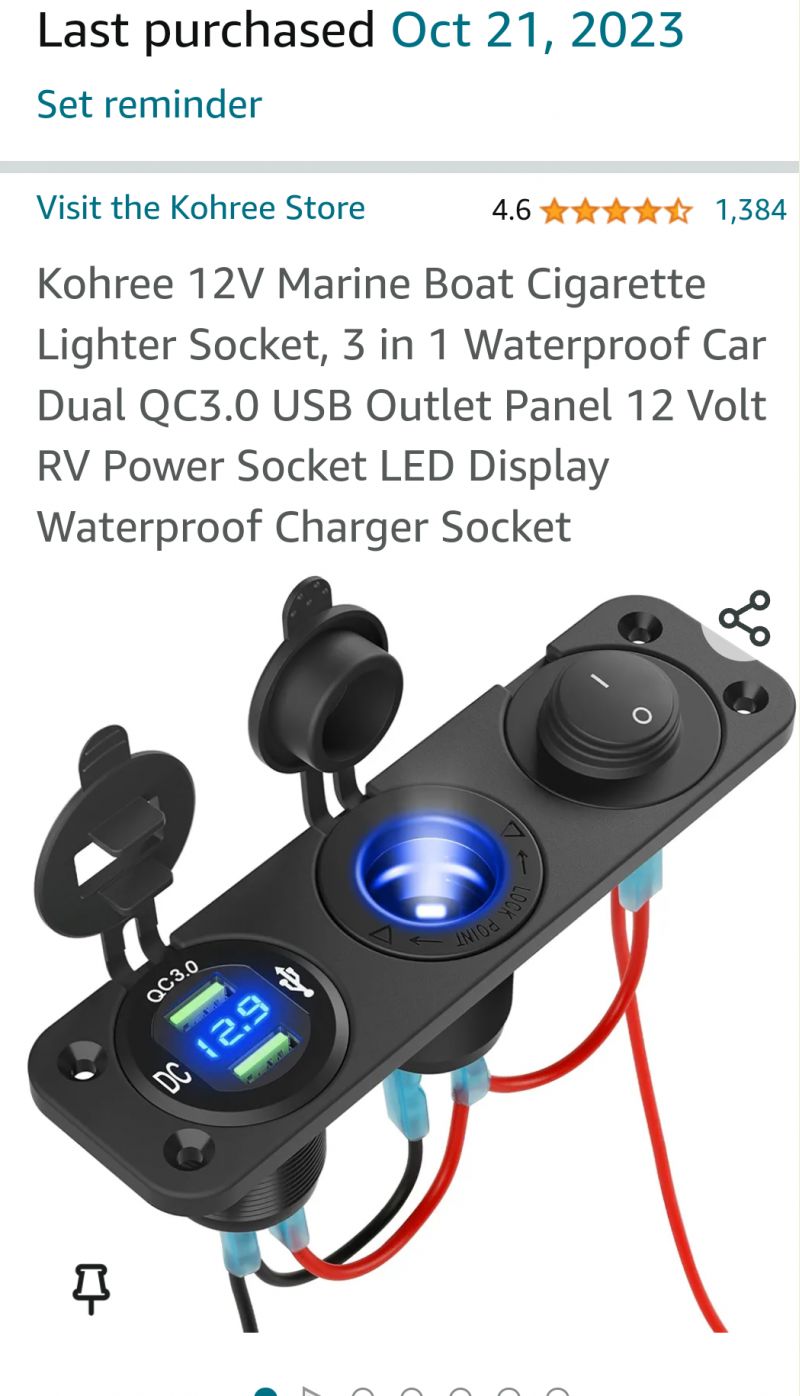

# Posted: 16 Dec 2023 07:12pm
Quoting: Brettny
A pair of USB outlets with a 12V cigerrete outlet.
I have used these before. Double USB, lighter plug and volt meter. Good price, fused and works well.
12 volt port
12 volt port

# Posted: 17 Dec 2023 09:03am
Quoting: darz5150
12 volt port
Have the link for them? The switch on the outlet could be handy to turn the setup off. I'm sure it has some type of draw even not charging anything.

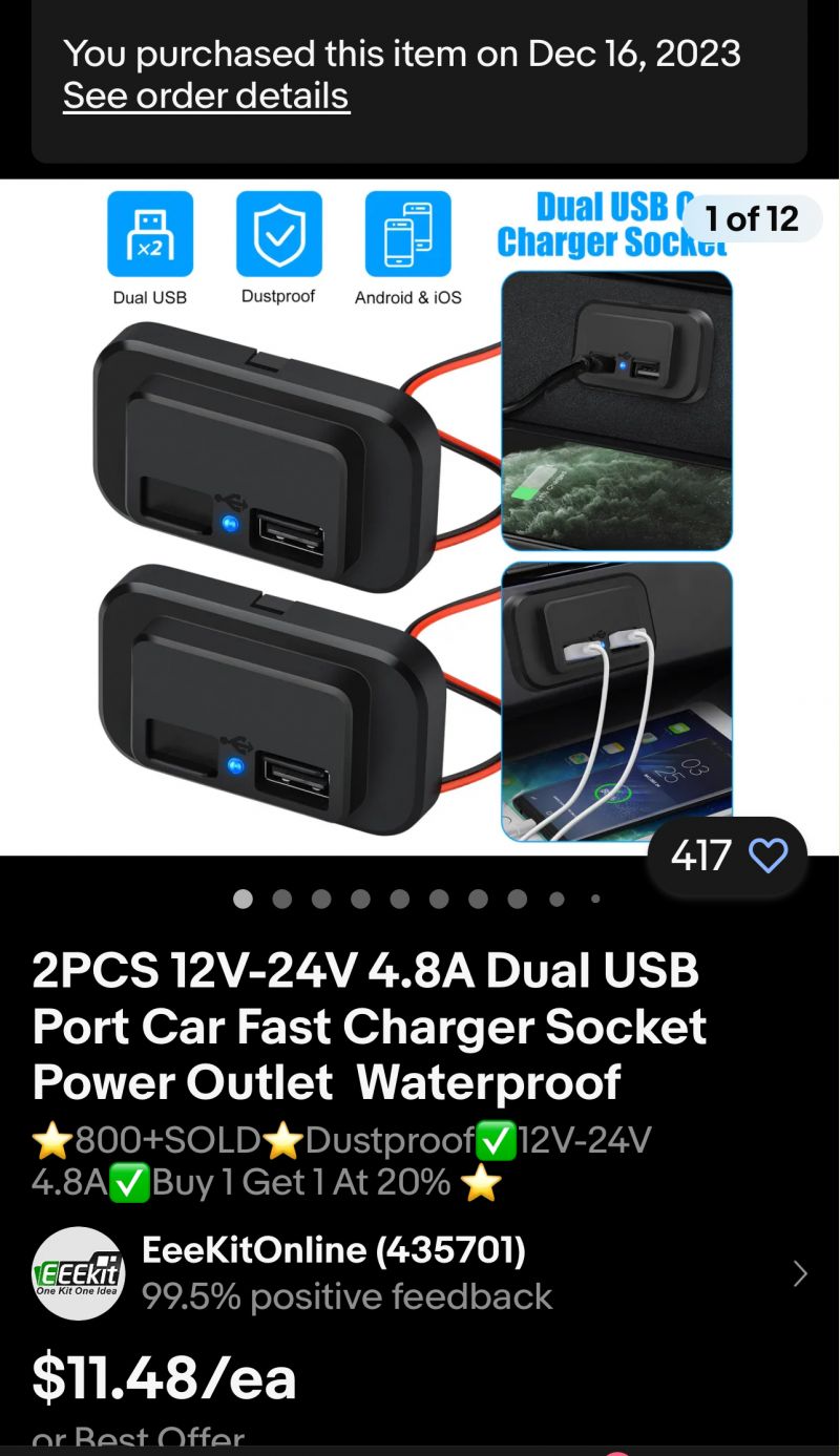

# Posted: 17 Dec 2023 09:32am - Edited by: paulz
I bought these just before Darz posted his. Probably wrong anyway..
https://www.ebay.com/itm/185133264454
# Posted: 17 Dec 2023 09:43am
Brett. Amazon. There's quite a few different configurations.
