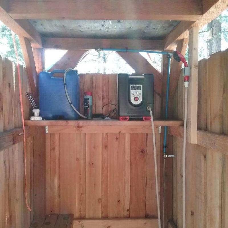

I have used a Mr Heater Aqua Cube. I set it up in an outside shower enclosure, but just a small amount of propane used when heating, shouldn't be an issue. If its cold, I will just take the unit inside when done.
I draw water from big mouth blue barrel, but on the roof, I have a 50 gallon drum painted black to absorb heat and can refill inside jug with it or shower directly from overhead barrel if its warm enough.

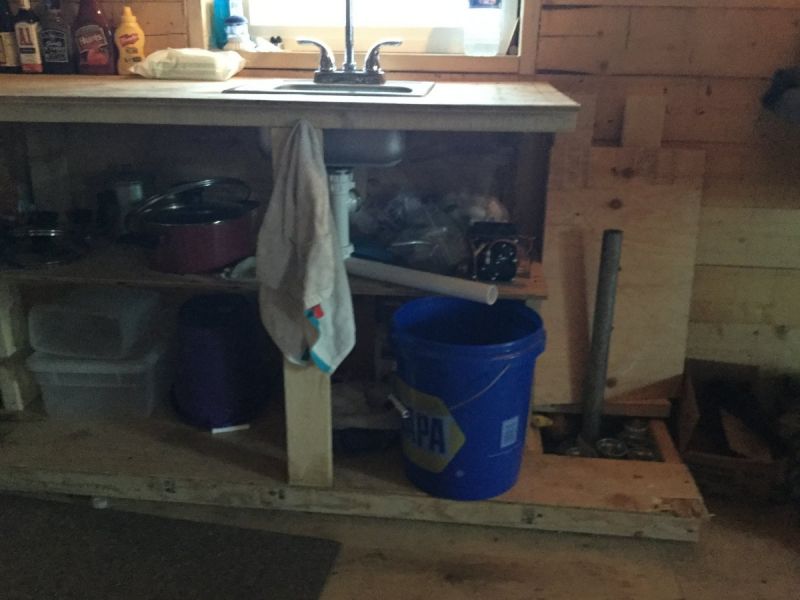

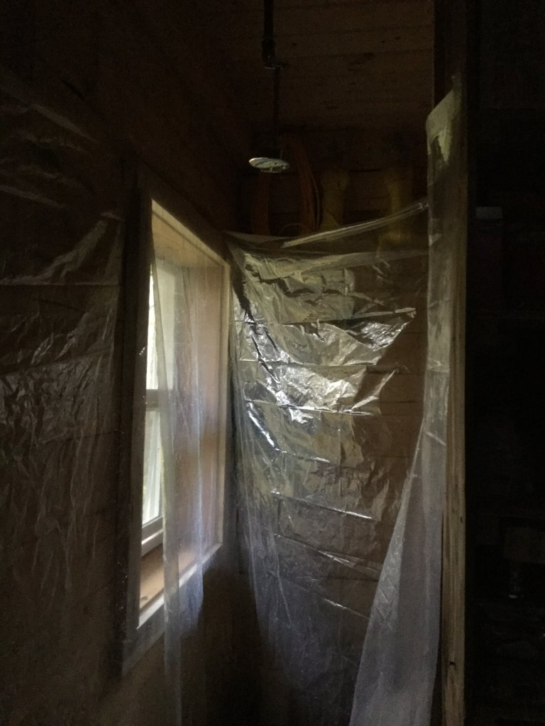

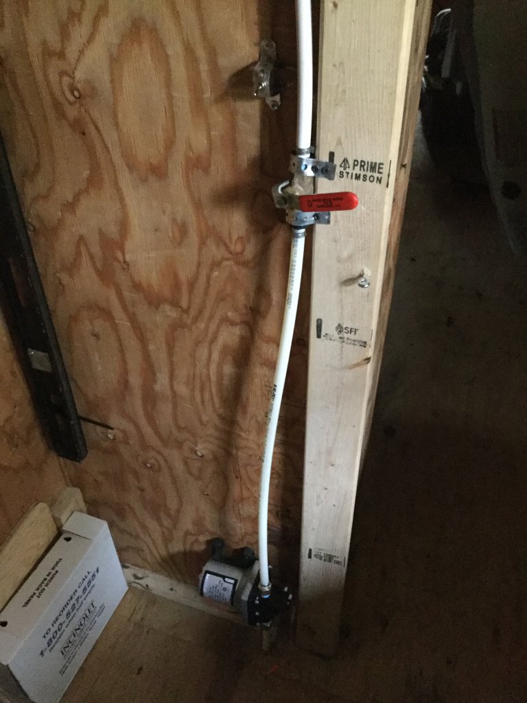

We have a 4-5 gallon pot that is used for boiling water bath canning. It sits on the woodstove and get warmed up. I have a surflow 12v pump that runs off a 12v battery. I ran a plastic shower line so that it can draw from the hot water bath pot and to a small sun shower head in the bathroom. We have a 4' long plastic tote that normally holds sleeping bags while we are not there for a catch tub. Set up under the shower head. I staple a clear plastic shower curtain to the walls and it diverts water into the tote. To shower I installed a toggle switch to run the pump in a convenient spot to turn on n off. Turn on n get rinsed off. Then off. Then soap up , and rinse. I also put a quarter turn valve in line to control flow volume.
It's a simple system and my beautiful wife n me can get cleaned up. If you want you can add another water pot to the woodstove.
A picture of the shower set up. And the view while taking a shower is kinda nice too. You can see the pump . I have it under the sink and will use another one to lift water from the sand point well under the sink. That hopefully will get finished this winter.
