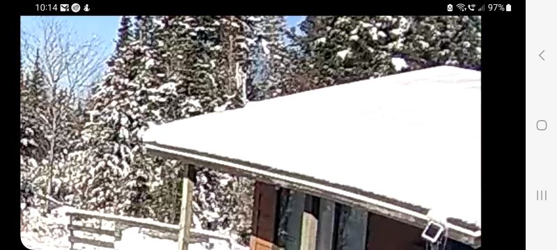

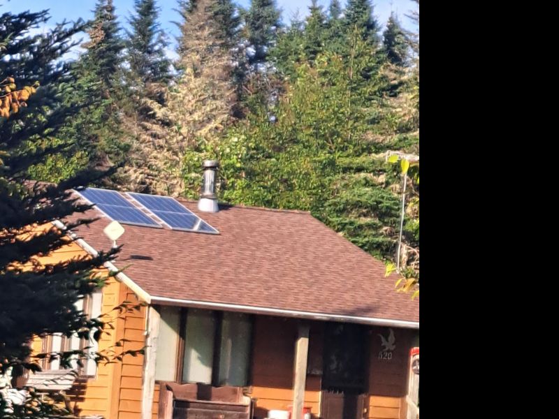

I have a remote cabin that's left unattended. I have solar panels on the roof and the snow seems to stay. Anyone have any thoughts' on how to keep the snow off other than training a squirrel? Thanks

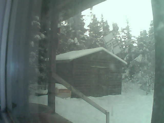

I have a 200 watt pole mount and a 405 watt pole mount (in picture) the pole is starting to lean and the trees are growing up around them. The 200 I could adjust the angle for winter, but getting to old to climb that ladder. Was going to move the 405's to the roof in spring, but perhaps an angle adjustable ground mount would be better.

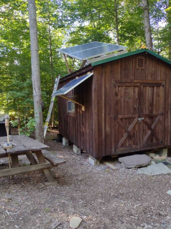

This is my temporary setup. The pannels on the roof I can get to with a normal plastic edge roof rake and the lower one has a kickstand that I remove every time I'm not there making it vertical.
My real setup will include 700w on the steepest part of the roof here..about 28/12 if I remember right. It will also include another 700w on the not so steep part that i expect to be totally covered in snow for 4 month out of the year.
I dont want a ground mount. I just think they dont look good and I'm covered in trees here. 1677064220414.jpg
