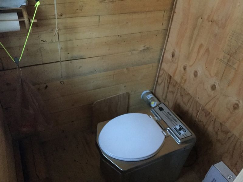

# Posted: 2 Jan 2024 11:40am - Edited by: Aklogcabin
At our remote cabin. We have an Incinolet incinerator toilet. Uses 30 amp electrical circuit. It burns the waste. Absolutely no odors either. Just push the button and it working. To clean just empty the ash pan which has very little ash. Easy to install using a 4" abs pipe
Would work well in your situation

# Posted: 3 Jan 2024 10:18am
Paulz the Incinolet toilet takes about 40 minutes run time. I fire up the generator at the same time and charge the batteries and run the refrigerator/freezer to keep things frozen or cold.
If someone had grid power it would be perfect. But we get by fine. I can open up the shoot in it and install a bunch of good plastic garbage bags and use it a couple times and then dispose in a hot fire if I wanted to. Or put it down an outhouse hole that will get burried. I want to make an incinerator out of a 55 gallon drum with a fuel fired burner from a fuel furnace. This would burn waste also.
But firing up the generator is pretty easy and no big deal. Just always looking for different ways.

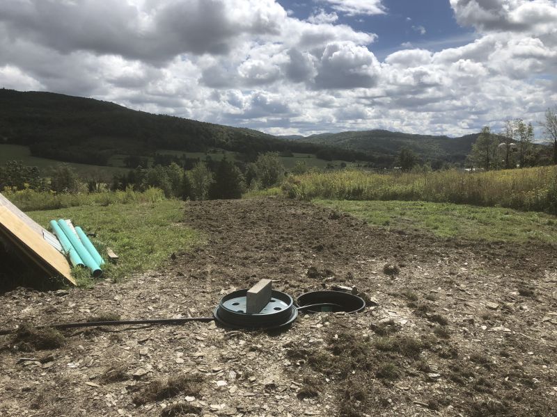

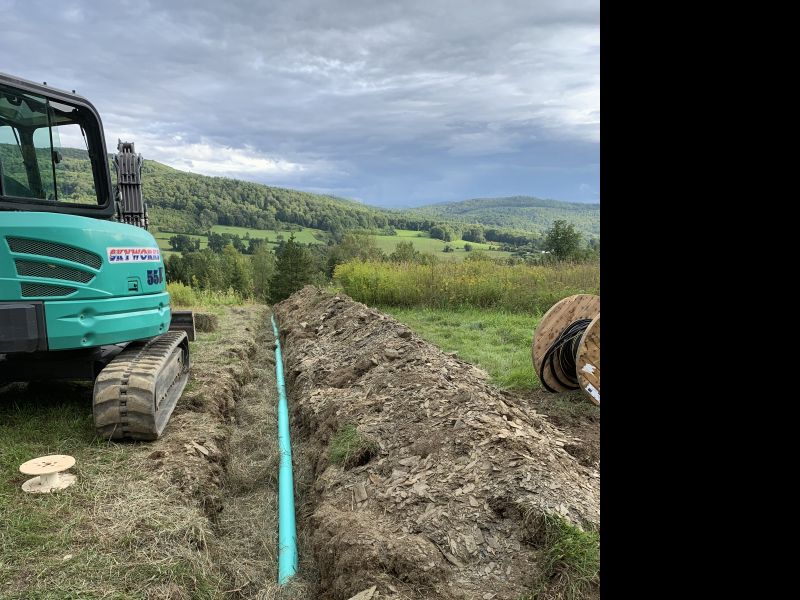

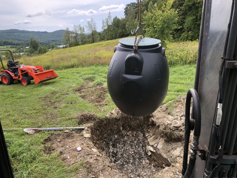

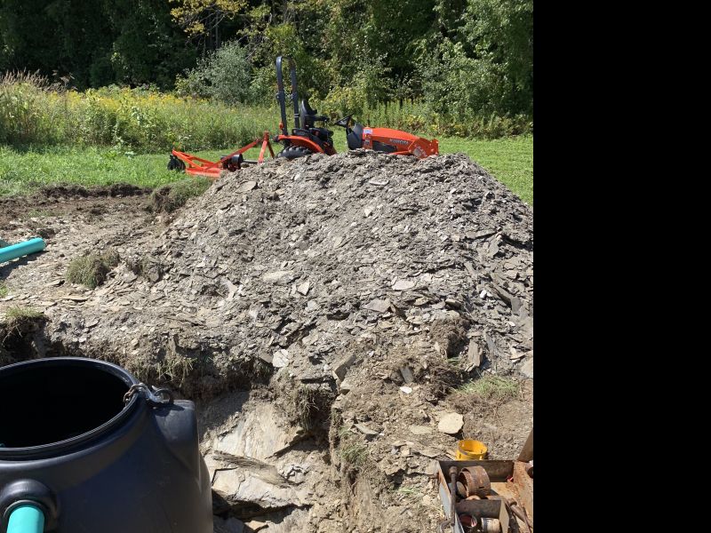

# Posted: 6 Jan 2024 08:14am
I built mine with a 300 gallon tank and gravel leach field
