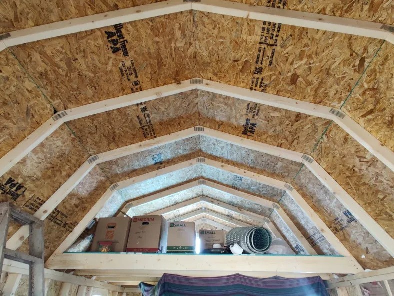

I've got a 10x18 prebuilt with a gambrel style ceiling. No room for soffit vents, was not built with a ridge vent. Winter here in northern AZ is settling in and I cannot find a decent answer as to how to properly do this.
Rafters are with 2x4s so there's not a lot of space to work with. Best solutions I've found are to either :
1: Spray foam the whole ceiling, or
2: Rigid foam board with spray foaming the seams/edges.
Fiberglass has sorta been rooted out as an option as I do not have proper venting or space options for it. Anyone have experience with a gambrel style on 2x4s?
I need some temporary insulation for the next few weeks. I run a pretty decent propane heater inside for now but have a wood stove that is yet to be installed. For now its a bit too cold. Until I find a proper solution for the ceiling, would it be feasible to put up reflectix across the rafters to keep some of that heat in? Uploading pics for reference. Thaks y'all! Turning to you for advice. Been researching and googling for a while now.

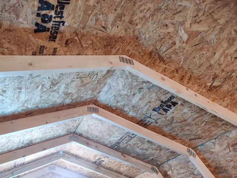

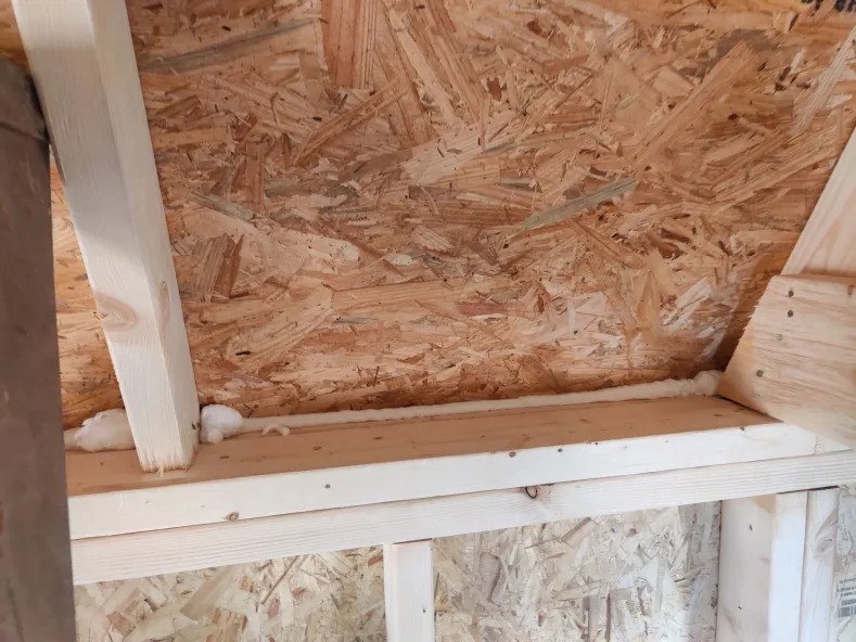

Pics of the non-vented ceiling and the sealed soffit areas inside

Bays are 24 on center up there as well.

Don't bother with reflectix.. Waste of money and time.
Based on your pics and description, you really only have one "good" solution. Spray foam.
DIY kits work, but is a really horrible job. I would hire it out and since I was bringing them out, I would just have everything done (ceiling, walls, ect).

I took the roof off and put down sheathing, foam board, more sheathing and the metal roof. It’s been the best upgrade yet.

I agree. With 2x4's framing the roof all you can get with spray-in foam is something between R10 and R12. Doing what Cedar Fever did may be more work but you can have as much R-value as you desire.

Best permanent option for you is spray foam.

I would do what cabin fever did. With the heavy sun load your going to have on that roof 3.5in of insulation isnt enough. That's not even enough in a semi cold climate.
