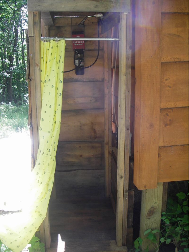

I have two of the Coleman models in use for several years now. One I have hooked up to provide a shower in an existing shower stall in my cabin. One is for the kitchen to wash dishes - although I've found that by using an electric tea kettle (elec available) it's a bit easier and leaves more room in the counter. I purchased 6' of 3/8" clear vinyl to make the longer run from the shower "storage tank" - a 7+/- gallon tall kitchen can that gives about 2 good showers before requiring refilling. I built a small shelf to hold the sewing machine sized Coleman unit and it's all fairly compact considering. I keep the lid on the can to keep debris and bugs out, with just a hole cut in for the pump and tubing to run through. I also have a small note pad taped on top and mark down each shower so I donn't get surprised when it's out. I get about 5-6 2.5 - 3.5 gallon showers before it needs to be recharged - not much warning when it's out, it just stops. I plug it in and later on in the day/night it's charged up and ready to go. Sorry, never had the time to watch and time it. I also have a spare battery charged up (available at Home Depot and Lowe's).
These are the difference between being able to use my cabin in the winter and not being able to use it. Mike
