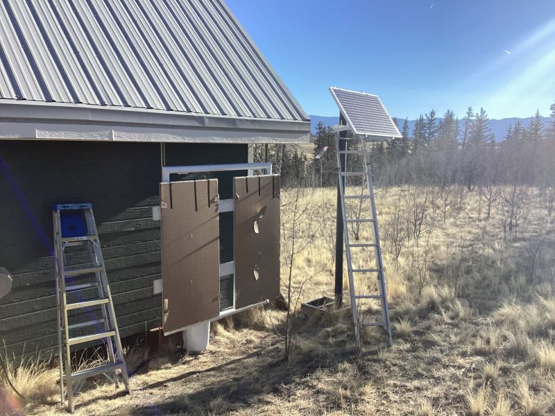

The present set up is 2- 200 watt Grape Solar panels. They are great. Do what they are asked to do. 5 lights and iPad/phone charging.
I sold my reloading equipment today and started thinking. Thats bad!
If there was an upgrade to where I could run a small fridge/freezer off the solar, what would I need? Do I sell the panels I have? And go totally big?
I will enclose a picture of the present system.
Any suggestions? Mixing and matching is not the best, I know.
The location is Colorado, with a great southerly exposure.
What did I miss? TY
Looking forward to spring, for sure.

A few questions first.
- Is this a part-time or full-time use ?
- A fridge/freezer combo or separate ?
- Do you already have them or are you planning on getting new ?
- And seriously, ask yourself, IF you have regular electricity available, you'll use lights & other stuff too.
You have to figure out how much load you may have to service for anything in use. Most likely the fridge will be the heaviest startup, even the new efficient ones.
A typical system will have a Solar Charge Controller, Inverter/Charger and a battery.
These days, portable power stations with batteries that can use solar panels can actually provide ample power, if need be, a generator could be used to recharge. Most of these are no bigger than a small to medium sized generator and don't weigh as much.
Something like this in the 2000W capable range would likely handle your needs and if it has built-in solar controller you can just plug into, it's a WIN! Note also that many also can be expanded by adding another "module". There are quite a few January Sales on right now too.
frankpaige
# Posted: 14 Jan 2024 11:28pm
Steve,
Definitely part time.
fridge or freezer. One or the other.
I do not have them. Just came into some extra cash. Thought that maybe I would upgrade.
I did the power company estimate. 28-32K. NOPE!
I really have no enthusiasm for trying to charge with a Jenny. The Jenny is for microwave and coffee pot in the morning.
Have considered the propane fridges. Just not a big fan of what I see.
So? You believe that it is going to be more in the range of 2K?
