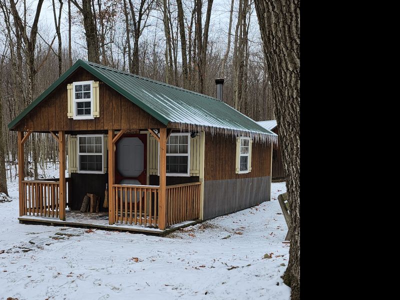

Hello, I have been exploring the possibility of using one of the cheap Chinese diesel heaters for supplemental heat at the cabin. I have seen a number of YouTube videos where people modify a cheap diesel heater to run on the exterior of the cabin and blow heat inside. Typically with a 12V battery with the heater outside as the power source.
My setup is a 12x24 cabin on skids, gravel base. Power is a Honda EU2200i and a Bluetti AC180. Main heat source is a boxwood stove woodburner.
My thoughts are that a diesel heater might be able to supply heat overnight as the boxwood stove has a limited burn time. The battery could then be charged back up the next morning from the generator along with the Bluetti.
Does anyone have experience with these diesel heaters and is it feasible to mount one on the cabin exterior?
Thanks!!
