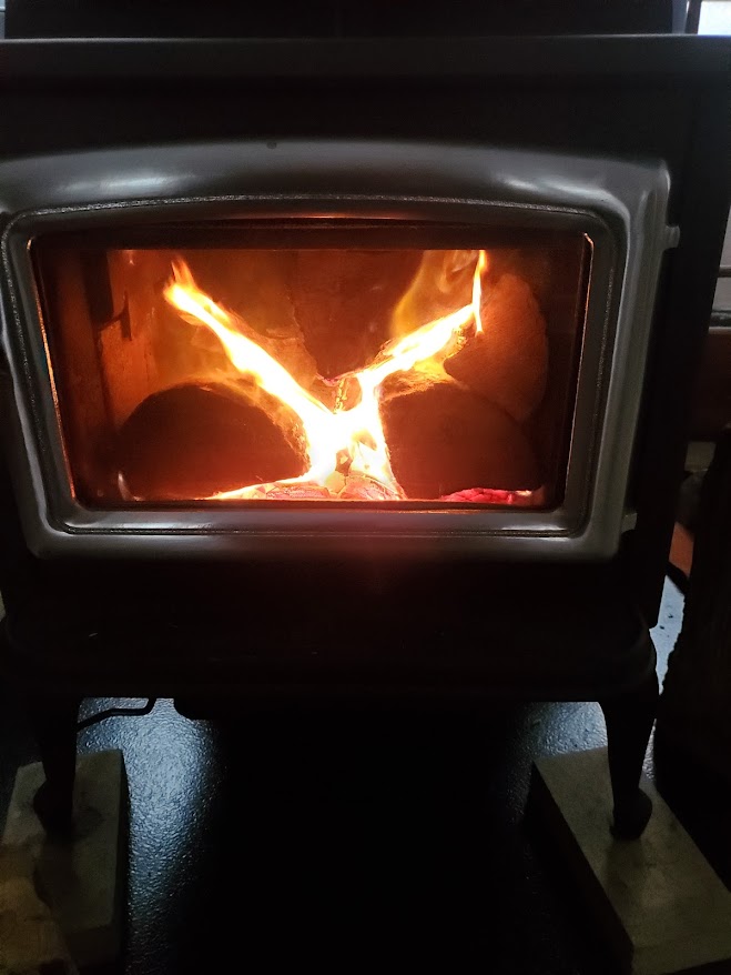

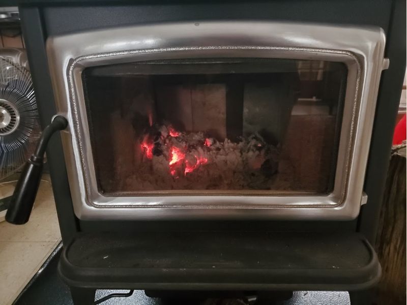

Here is my Pacific, very little soot if dry wood is used, will keep heat from 10:30 till 6am
