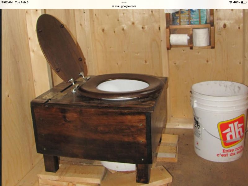

We’re in Ontario Canada and we can get pretty cold winters. We head to the cabin 6-8 times during December- March. We have indoor plumbing and water but both are shut off for the winter. For washroom facilities, we have found simple works for us. My wife and her girlfriends have used this system for years in winter, though some women may be “too fragile” lol…to consider it.
We built this toilet box originally in our outhouse, and still keep it in use all year as overflow when company comes to not overload our septic. I simply put the box in the washroom in the winter beside ceramic toilet. It’s built off the “ humanure” concept. Once we go number #2, we simply cover with a couple scoops of peat moss. Peat moss is the key since it absorbs both fluids and smell. If I have a really bad #2😂, I simply crack window and spray a squirt of deodorizer….but honestly, smell is gone very quickly because of the absorption by the peat moss. When it’s full, I simply dump in our designated area where it gets composted for flower garden. Bucket is rinsed clean and back into the toilet box.If you want, you can even dump after each #2, so there is always a fresh bucket. This won’t work for everyone, but it is simple and works…and it’s inside where it’s warm. This system is also used in some southern states as back up where power outages are common.
# Posted: 6 Feb 2024 09:43am
Looks inviting! 😀
bushbunkie
# Posted: 6 Feb 2024 10:58am
Better than a cold seat in a winter outhouse!😂
