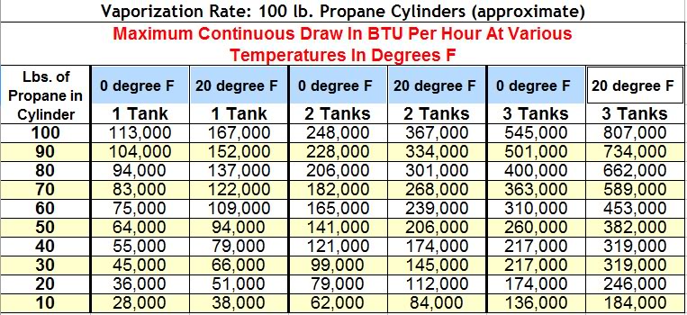

Even if a 100 lb cylinder was only 10% full it should provide sufficient volume and pressure of propane for a 20K heater if the propane temperature is above freezing. That assumes proper diameter piping and average pipe run lengths.
If the heater did work on an almost full tank but not a tank with low level that would indicate a temperature or some sort of other pressure/volume issue.
See the table listed below.
My first thought would be the regulator could be at fault. The remote location of my cabin means it would be very difficult and costly to have a service technician come out. I have a spare regulator at the cabin as one winter I did have a regulator cease functioning. Cheaper to have a spare and more convenient.
FYI, when installing a regulator it makes sense to me to install it with a pipe fitting union rather than simply thread the run of pipe into the regulator. Then, if or when it must be serviced it can be easier to undo the union instead of having to spin the regulator to unthread from the pipe.
100# parallel cylinder connections

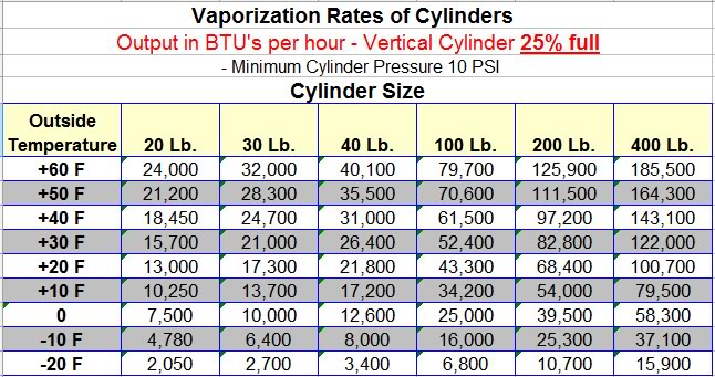

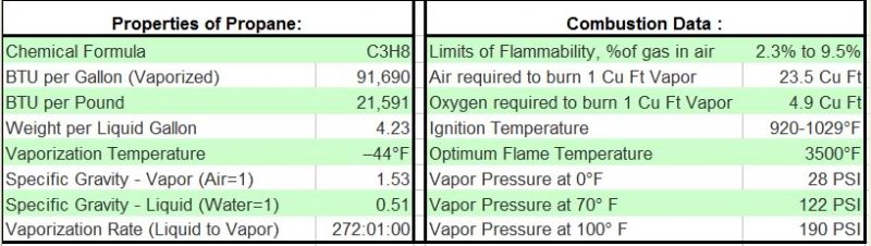

# Posted: 6 Feb 2024 03:22pm - Edited by: ICC
The table above is not mine. A friend made it years ago. He also made the following tables, which can be useful as well. I think they have been listed here before.
asst'd cylinder sizes
vapor pressure & temperature
properties
properties
