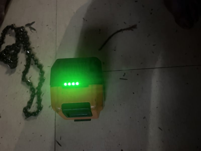

The battery that powers both my chainsaw and leaf bower, my two most used stuff lately, went dead. Weird, don’t know why, been reliable for a few years. Put it on the charger, nothing, charger won’t even light the charge light or start the fan. No lights on battery, always stops the tool when it gets down to two lights.
Put a VOM on it, zero volts. Hmm, maybe it finally bit it. In desperation (I have a ton of branches to hack) I jumpered two car bats in series to it (it’s an 80v bat) for a few minutes, then shoved it in the charger. Vroom, charge light and fan! An hour later I was at full charge! That was last night, still full charge and tools running today. Yahoo, so far. Still clueless as to what happened. Maybe left it in a tool running? Would have heard that. Never under 40f here.

Some batteries can go into a sleep mode once charge gets too low and require a wake up charge to get them going. Glad you got them working again

Sounds like the BMS shut it down when the voltage dropped to the Low Voltage Cutoff.

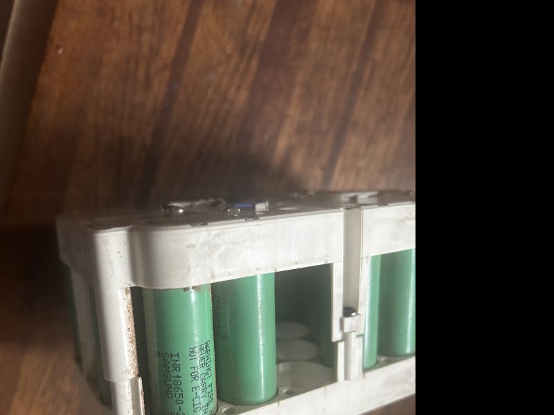

Well I got a few days chainsaw work, but finally bit the big one and bought a new battery. The old one, oddly, still shows 3 lights, measure close to 80v with a VOm, but will run the saw for about3 seconds and shuts off. Plug it in the charger and the red (fault) light goes on with a click, no charging.
So I did what any red blooded American man would do: took it apart. Surprised to see 18650s. I don’t see a ‘flip this switch’ sign anywhere and it looks kinda complicate. Oh well, it did me good for lots of work.

like Lead batteries, they can charge up to voltage, but fail load test very quickly. Likely one bad cell in that battery, usually the rest are fine.

I agree. Usually just 1 bad cell. Manufacturers make it so hard to tear the pack apart, you basically have to destroy it to get access.

Well the thought of just replacing one cell got me excited, would make a great spare battery, but you’re right, they are covered in special screw heads, glue, solder.. no plug and play access there.

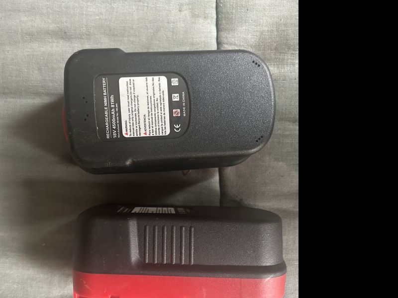

On another note, I recently bought two new batteries for my old B&D saws. $25 a pair, brand new, delivered! They aren’t Li though, rather MIMH old tech. Much shorter on grunt but doing the job for me. I’m shorter on grunt myself these days anyway.

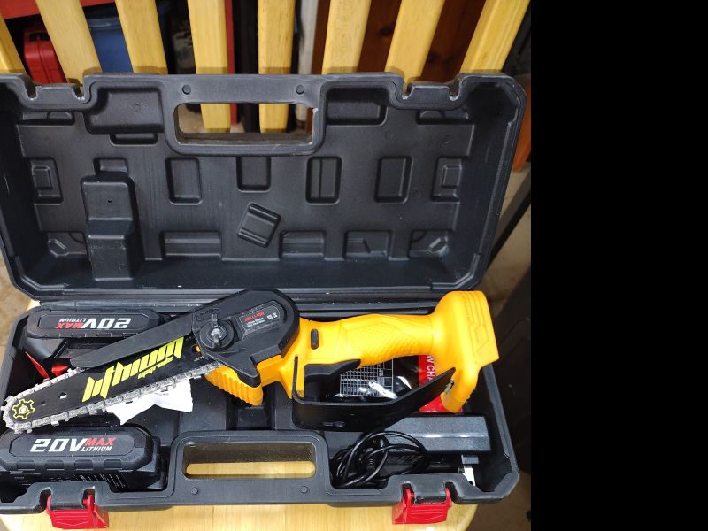

I recently bought one of those little 6 inch chainsaws, that I figured would be slightly better than useless. But it turns out, its really very handy. I used it for about an hour the other day clearing some face slapping branches off the trails and some other misc. crap laying around. Worked better than a recip saw. I cut a landscape timber in about 20/30 seconds no prob.

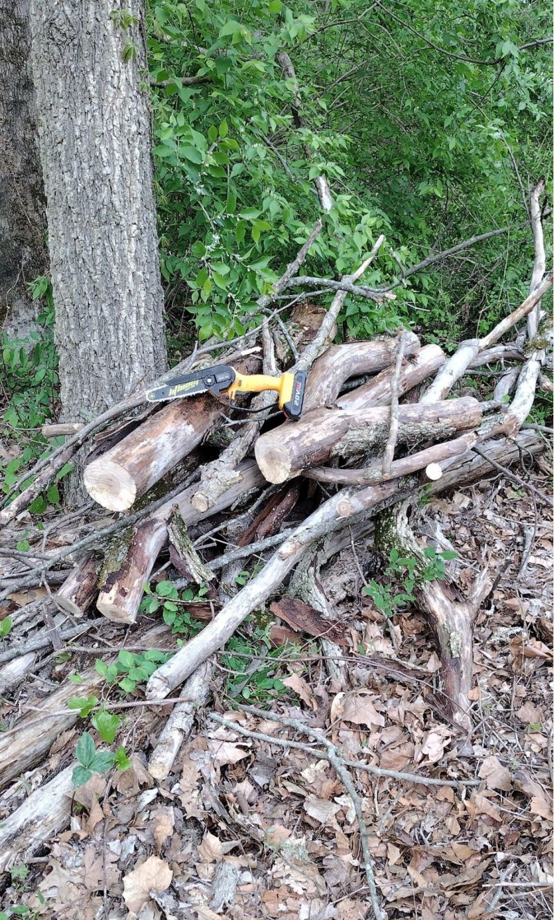

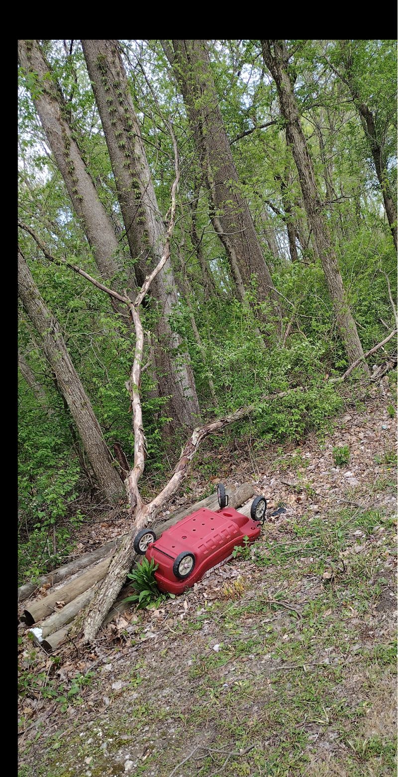

# Posted: 19 Apr 2024 07:17pm
I put the mini saw to the test. Had a pretty big top get knocked off in the storm last nite. About 8 inches thick at the bottom and probably 20+ feet long. The mini chopper worked well, and didn't run thru one battery. Still full speed at the end.
Before
Before
After pile
After pile

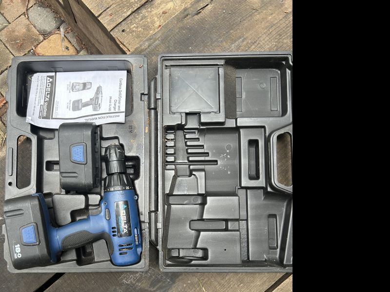

Was just given this Delta drill kit. Missing charger and they are dead Nicads. Looked around a bit, you can find Li battery adapters but at this point it seems the batteries and charger are the bulk of the value in these small tools. Probably just pitch it.
# Posted: 28 Apr 2024 02:00pm
If it is about 12vdc remove the bat and make +/- leads to clip onto a 12v battery
