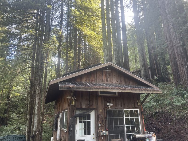

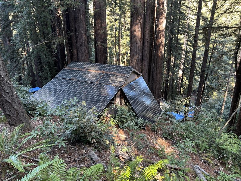

Here’s the front of my cabin (still a mess from the storms) showing the rain/sun shade made from panels. Just a few feet of 2x4 framing.
The shed with the main panels is visible above right.
