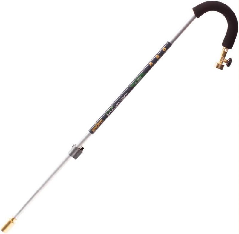

We keep one of these around for when we want to cheat. One of those little green propane bottles lasts forever (a whole season).
