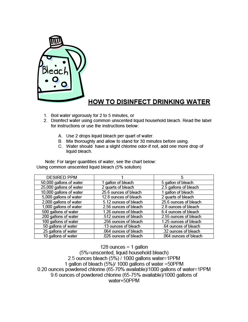

Hope this helps... I always shoot for ~3ppm

The FDA lists the ratio on there website I believe. This is for drinking it. I'm sure theres more to taking midday water and putting bleach in it.

That’s more in line with what I’ve been using. I guess the figure I saw was for 1ppm.
