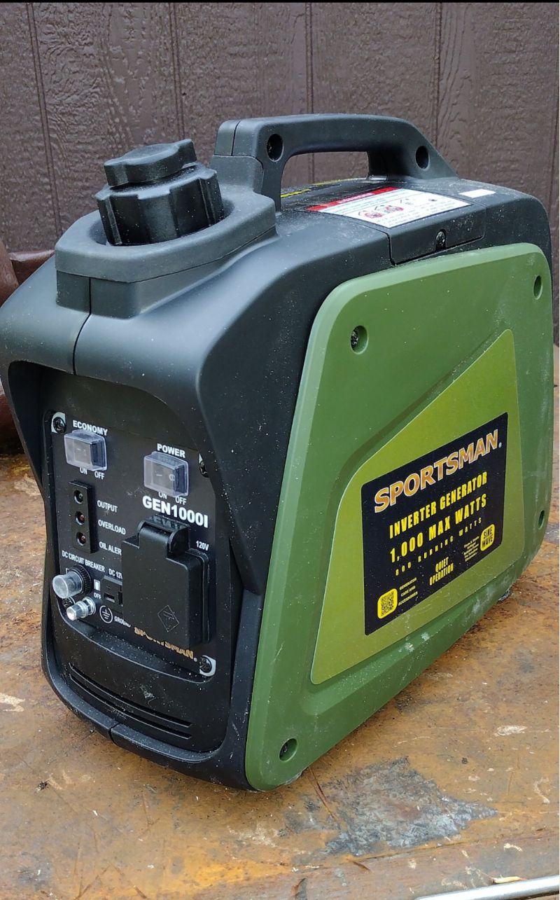

Does it look like this? I have owned one of these for about 3yrs and at 100hrs it started knocking, blowing smoke and shutting off. I almost tossed it in the garbage. I then as a hail Mary tried adjusting the valves and it runs like new. All I do with mine is put 30a at 12v. It will run nearly 12hrs doing that with a 0.5gal tank full of fuel. There also very quiet.

This is the one.

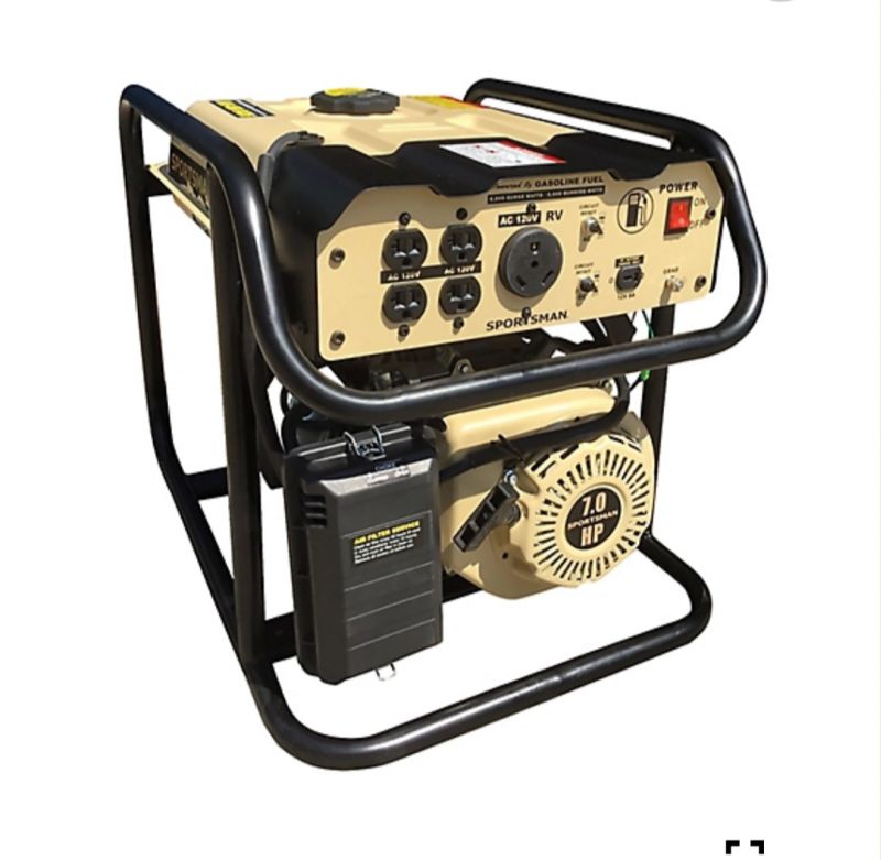

I've had a sandstorm 4000 duel fuel for quite a while and have never had a problem.

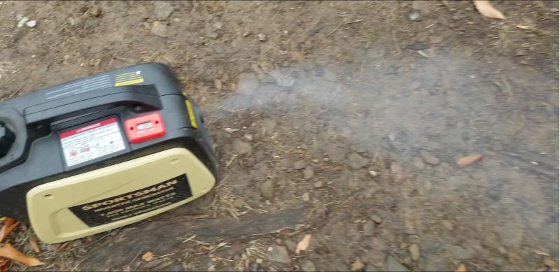

Had one of those die on me earlier this year, in the middle of showing a drive in move (just me and a pal fortunately). Started knocking and smoking. Might have been my fault, had it a few years and no maintenance. Pulled it apart, plenty of valve clearance. Felt rough to turn over, maybe piston or lower end. Gave up and tossed it. Reviews are good for most part, maybe just mine..

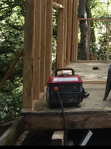

You mean one of these lol? Got a ton of use framing my cabin, before the little 4 strokes came out. It’s still here somewhere, unused for a long time.

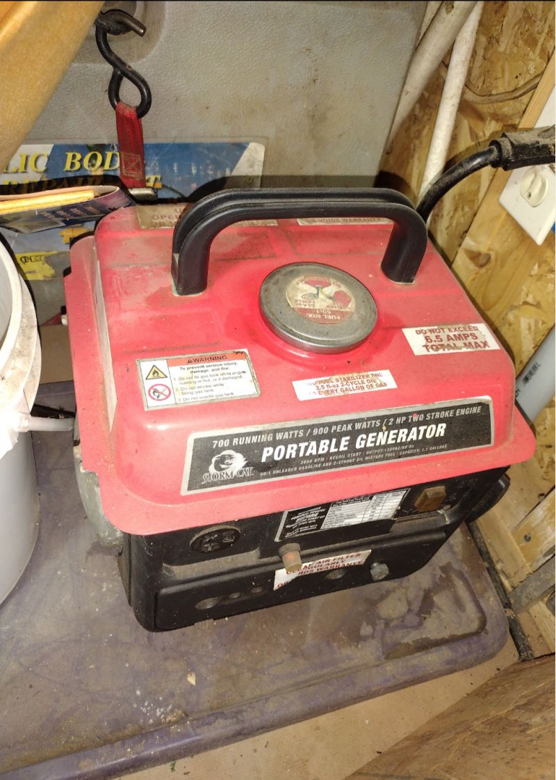

Lol. I've had one of those quite a while.
They are way off on the power rating.
Mine easily runs a circular saw or whatever.
I've bounced mine out of the back of the Log Dawg a few times. Still runs fine.
Ole smokey. Lol
