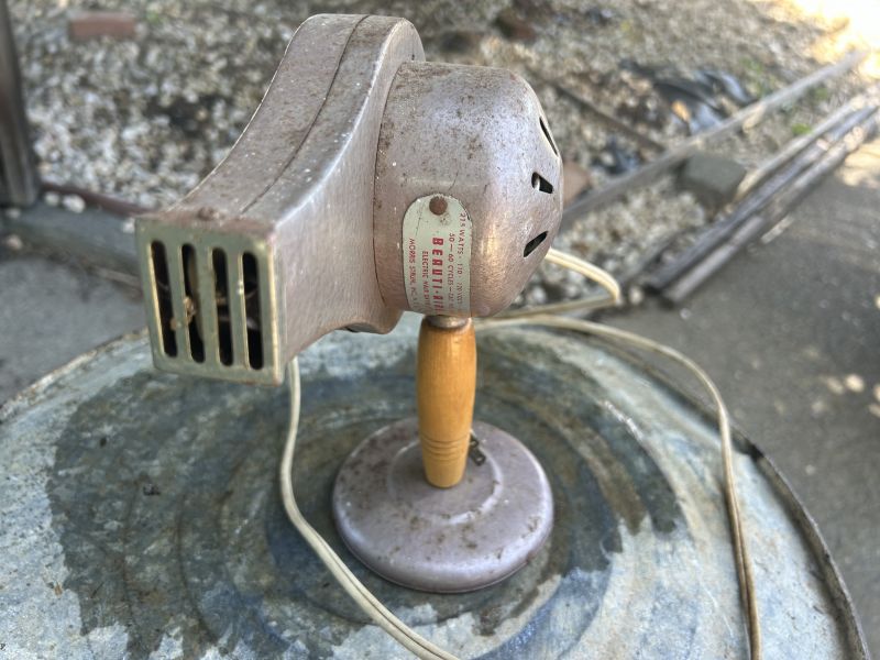

Just saw on diysolarforum that the 120v hair dryers run off an inverter make great load testers.
# Posted: 7 May 2024 12:16am
Just dug one up. Oldy oldy but works

Typical automotive load tester (afaik) puts on a heavy load as if using the starter to start an engine. Maybe the fancy ones have an adjustable load?
The hair drier on Hot will draw per the label rating for the low or high speeds letting you watch the bat sag from load over x time; ie, more like what deep cycle bats are rated by.

# Posted: 7 May 2024 01:49pm
Makes sense. Shoot I left that dryer at the house, be a few days..

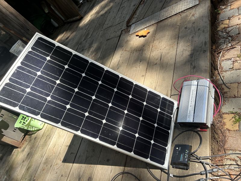

While waiting.. today a friend brought over his weed blower for me to fix (simple, rotted fuel line). The good part is he gave me some solar stuff he no longer uses: a renogy 100w panel, wanderer controller and 1250w inverter (msw I’m sure).
The controller has no digital read options, but it does have Sealed, Gel and Flooded battery settings. I wonder what the differences are?

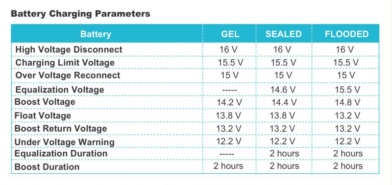

# Posted: 8 May 2024 01:47am
Found the charging differences between battery types.
# Posted: 8 May 2024 02:36pm
Started wondering about the charging differences (at least with this Renogy controller) and how it might affect load. There is no LFP setting (it’s an old one I guess), and no AGM either (maybe that’s the sealed setting).
Anyway drove me to this good description of the different battery types. Kind of long, haven’t digested it all yet.
https://www.foxtronpowersolutions.com/gel-battery-vs-lead-acid/#:~:text=On%20the%20ot her%20hand%2C%20sealed,with%20a%20glass%20mat%20substance.&text=And%20gel%20batteries %20are%20filled%20with%20silica%20to%20coagulate%20the%20electrolyte.&text=Besides%20 that%2C%20sealed%20batteries%20are%20virtually%20immune%20from%20spills%20and%20leaka ge.

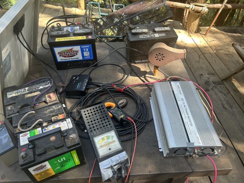

Ok first highly unscientific test done. Not much learned really, except I got some dud batteries. All showed full charges, over 12.5 overnight. The two big FLAs ran the heated dryer no problem, time indefinite as they would likely do it for hours. Of the smaller sealed bats, (AGMs?) only the fairly new one (2023 date) that runs my cart would run the dryer. The others would not even get it started.
Same results with the load tester, three tested in the green, the others went to nothing right away. Not much to learn really, except even after testing the bad ones still showed 12+ volts. So I guess you can have useless ones that still show good voltage.

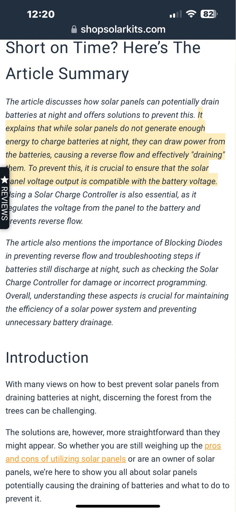

Ok good. I only did a quick search and read the highlighted. I did try putting a VOM on a panel in the dark, nothing.
From https://shopsolarkits.com/blogs/learning-center/do-solar-panels-drain-batteries-at-ni ght#:~:text=It%20explains%20that%20while%20solar,compatible%20with%20the%20battery%20 voltage.

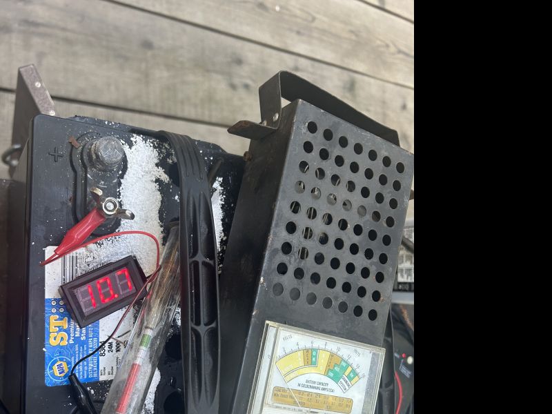

Speaking of apologies; I mentioned on the 30th the new/old FLA I got. So it’s been at the cabin hooked to 18v solar panel sans controller (1 amp or less). Poured some epsom salt in it, very carefully as you can see. Been stuck at 10.7 volts. Had my bat tools out yesterday for other stuff and stuck the load tester on it. Surprisingly it didn’t go down all the way like the dead ones usually do. Below the “good” range though as expected. Then checked it with the hydrometer, 5 cells in the green, one stone cold dead red. Hmm, maybe got a usable fla with one dead cell..
In the spirit of further time wasting, maybe I’ll drain that cell, flush it out or something and fill with good electrolyte out of another battery. 10.7/5 x 6 = 12.8!

I dumped that cell and the 2 next it in a pan, tapped on the bottom and refilled them with that mixture. On the charger, showing 12 and change so far but it’s done that before.

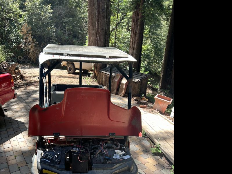

Probably but I have a lot of time these days, everything is done, lol. On the bright side, it starts and runs my cart. Only a V twin Briggs but it turns it over fine. The cart has a solar charger on the roof, I’ll unhook it and see how the battery lasts but it’s always there. 13.2 at the moment.
Glancing around, there’s the 3 tractors. 2 carts. Log splitter, generator, dump truck, 56 Chevy. All 12v car battery powered. Half sits battery les but nice to have spares around. Lugging car batteries isn’t as easy as it used to be!
