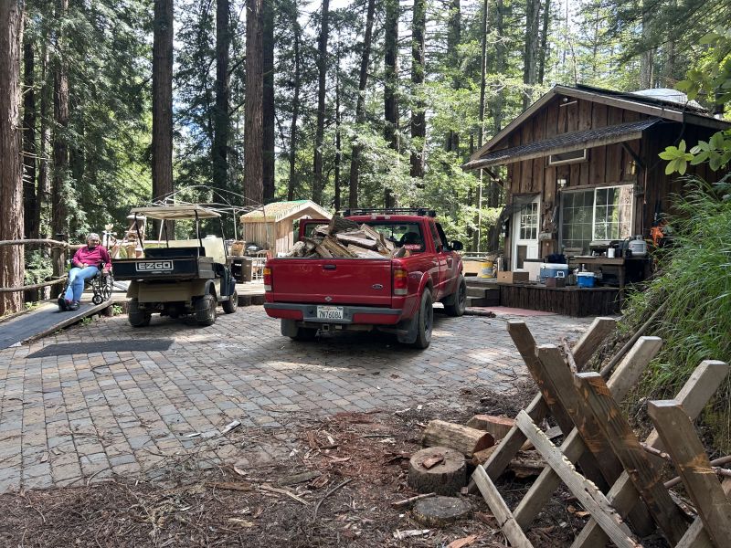

A friend I gave logs to made me this jig for cutting firewood (shameless photo of my cabin front included). Works great, toss a 6 footer on there, lop into 16” pieces. Got anything similar?

Yep. Looks like yours is holding up pretty well.

Thanks, could be a bit stronger. The 1x braces gets clobbered by the saw after it gets through the log, other side one in the photo is broken. Need to replace with 2x. And there’s no cross bracing the other way, depends on the V center screws. Ok I guess for folding, moving and toting.
It’s actually more handy than determining log length. It keeps you standing upright while cutting and the V keeps the log from spinning.

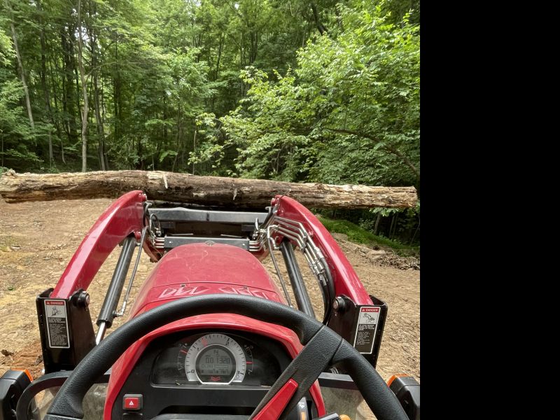

Yanmar firewood cutting attachment.
