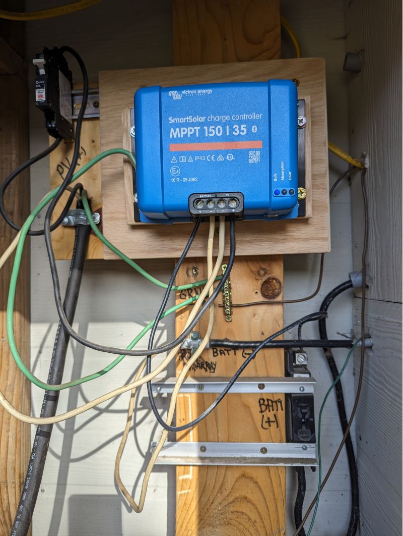

Back in 2011, maybe 2012, I upgraded my cabin solar power equipment. I used a Midnite Solar The-Kid MPPT charge controller that was a pre-production test unit. It has performed excellently ever since. (150 volt, 30 amp max). It was superb for my old lead acid batteries. However, I discovered one deficiency for some LFP battery use, and there is no firmware fix for it. More on that later.
I replaced it with. Victron Smartcharge charge controller, 150 volt, 35 amp max. I installed it yesterday. Installation was easy and it connected the the Victron app quickly, did a firmware update and started charging. Simple and straightforward setup. Today has been somewhat cloudy and we are already at almost 100%, but to be fair The Kid was very quick at charging too.
Why replace a controller that in almost all respects was working fine? There are some nice features but most of those are just gravy.
The SOK BMS with Bluetooth has a sleep mode and a storage mode. The BMS goes into sleep mode when there is no discharge or charge current detected. This is good. There is a very low discharge current, measured in mA that keeps the electronics live to watch for a charge or discharge current. If either is detected the BMS wakes up and the system works.
Storage mode is a manually selected setting that shuts the BMS down completely. The external battery connections are stone cold. No power. No danger from an accidental short curcuit for example. No small current drain at all. I like that for times when the system may not be needed for an uncertain interval, like over a winter.
Here's where the deficiency comes. When the SOK BMS is in storage mode only a charge current can wakeup the BMS. (In sleep mode a discharge can wake the BMS, even a low current such as a small DC power LED light)
The Kid charge controller is one of a few designs that will not turn on, or activate, until it senses the battery voltage. In storage mode, the SOK terminals are dead, no voltage. The Victron controller, on the other hand, stores the battery voltage in ROM memory. It has the ability to wake the BMS from storage mode once the PV panels receive enough sunlight to provide a usable voltage. Therefore I don't need to run the generator to wake the BMS from sleep.
After Victron dropped their prices last winter I decided to go for it.
Now I have a spare, or may see if I can sell The Kid. It is still in the Midnite Solar lineup. A new Victron is cheaper though and the Bluetooth app is very nice to have. So if I sell it would be a relatively good price.

That is not the tidiest wiring I have ever done. It is functional. The breaker at top left is from the PV array. The breaker at lower right is to the battery. Large black cable from bottom left is power from the PV array.
Next, I have a Victron SmartShunt to install, but I forgot the hacksaw I need to cut the buss bar.

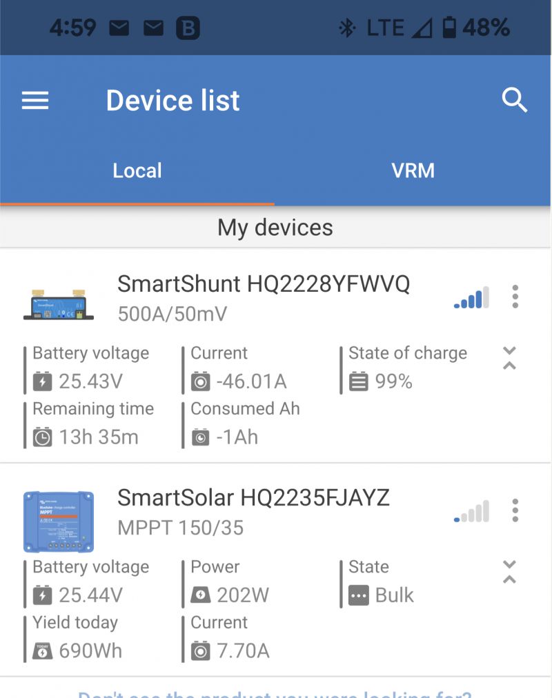

Today I installed the Victron Smartshunt on the cabin solar system. It was a very easy install, connected to my phone bluetooth right off with no issues. It is nice to have both the shunt and solar charge controller accessible on the same app. The screenshot shows the data while dinner was warming in the microwave.
That view may be expanded to display more data from any one of the connected devices.
The SOK battery was at 100% when I started warming. I noticed that the Victron controller switched to bulk charge more quickly than the old controller did in the past, under similar sun conditions.
All-in-all I am pleased.
