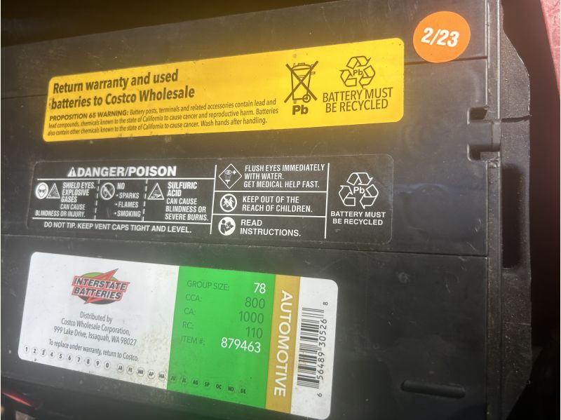

Here’s the top of my truck battery, think it will pry open? I’m curious, but not that curious. It’s a 2023.

I have a smaller car battery like that powering one of my pumps. I popped the top off.
Glad I did. It's hooked to its own solar panel and yes it needs water from time to time.

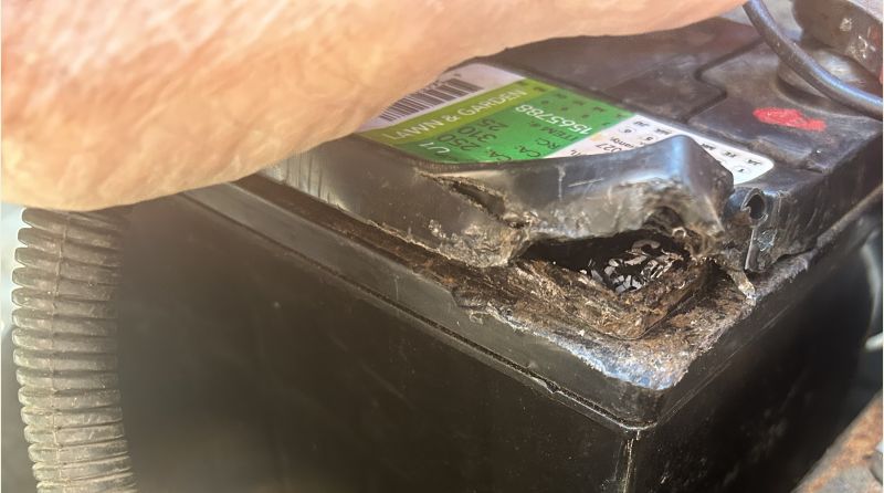

Thanks Darz. I have a 2023 cart battery, also an Interstate from Costco, much smaller and under 50 bucks iirc. I just tried to pop the cell tops (one piece) off, no luck so far. Put some divots in the plastic. Do they have the same cell seals as removable ones? Any tricks? I don’t mind wrecking the piece, just don’t want to puncture the battery.

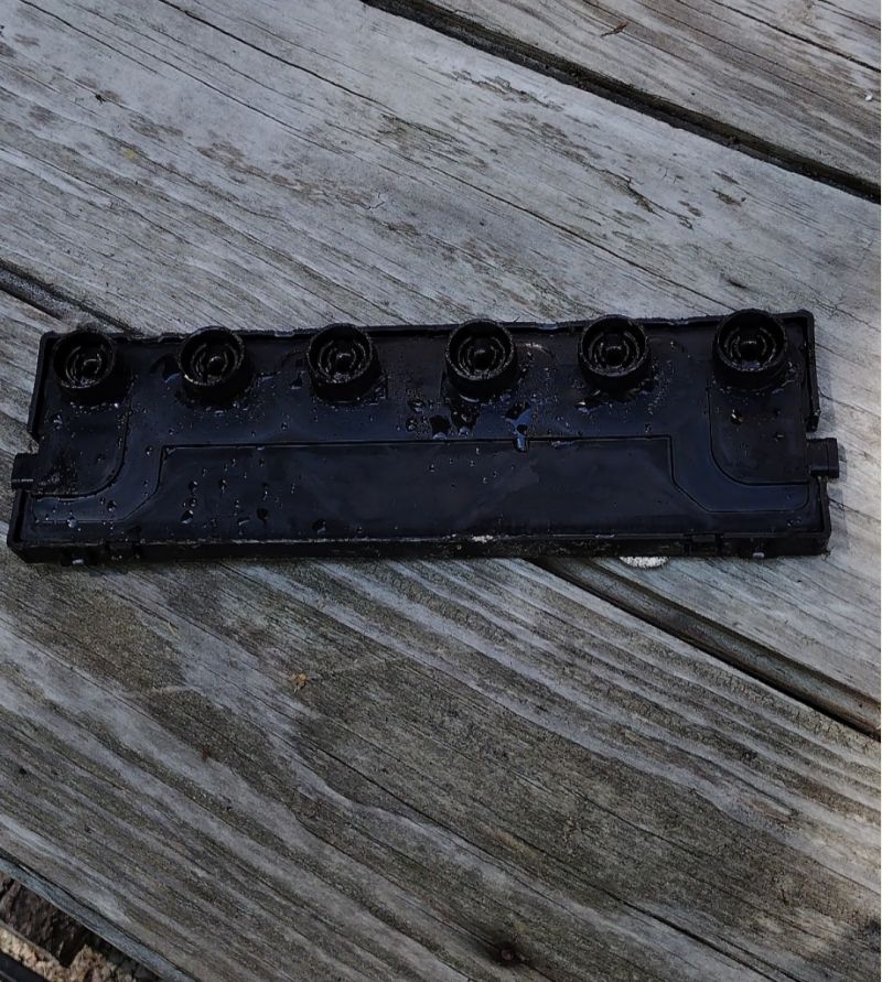

Mine is a Never Start from Waldo World.
I used 2 stiff putty knives to pry the top off. The retainer tabs are toward the outer edges.

I’m not good with Celsius, 5 is about 40F? That’s pretty warm, probably sell a lot more if they could take less temp. I have seen a high 30 at the cabin once or twice, outside, however the LFP bank is iodide at a toasty 70! Probably never hits below 50 inside when I’m not here and sun is out to charge. I do have BMS.
Well I bastardized mine a bit more. Looks like it may be glued on. Quitting while I’m hopefully still ahead.

Mine.
# Posted: 15 Jun 2024 12:19pm
I had to pull the stick-on label off the top of one to expose the flush mounted call cap strip.
