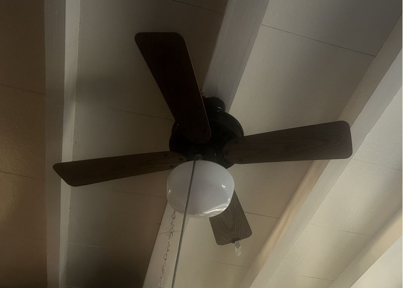

I’ll try that. Happen to be at the city house for a car smog test today. Had that fan on last night (ugh, only 25 miles east of the coastal cabin but much hotter) and noticed something odd.. I usually run on low speed, where it wobbles like a drunken sailor. Yesterday I ran it on high, smooths right out, almost livable.
As shown it’s only 4 blades. It’s right above the bed, allowing for hours of aggravation. Also you can see the one clip I have on there, and the same ‘remote control’ rope system the cabin one has.
