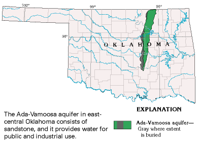

drb777
# Posted: 28 Jun 2024 12:59pm
Aquifer map

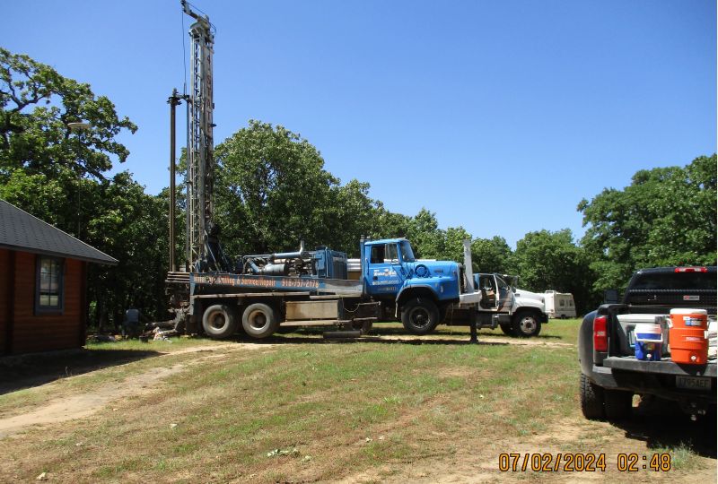

# Posted: 3 Jul 2024 02:15pm
We ended up drilling to 180' and tested at almost 9 GPM. I won't get it completed for about a week, but the hard/risky part is finished. It'll sure be nice not having to haul water. They told me they recommend using 1/2 HP pumps only to 100', so I can't use an existing pump I have. But a 3/4 HP pump & 1" tubing will soon be installed.

# Posted: 3 Jul 2024 03:59pm
Quoting: paulz Do you have or have plans for an above ground holding tank? Since I already have a 300 gal storage tank and pressure tank inside the cabin, my plan is to simply refill the tank periodically from the well, and use the tank for settling purposes. I may never actually use well water for consumption. (I don't live at the cabin full time.) But I'll certainly keep in mind some filtration as I see just how "clean" the well water becomes. The 5-inch "slotted liner" on bottom is rated at 20 microns (extremely narrow slots), so after initial clean-up, I'm not expecting a significant solids/sand production. But only time will tell. To fill the annular space, we used 6 sx of pea gravel, followed by 6/10 gravel (sand) up to 22'. Then Bentonite chips from 22' to 12'. And finally cement from 12' to the surface. 'Not sure if this is standard elsewhere, but the drillers said it was for them. (I supplied the pea gravel since I had some, and it tends to "fall" downhole much faster than sand.)

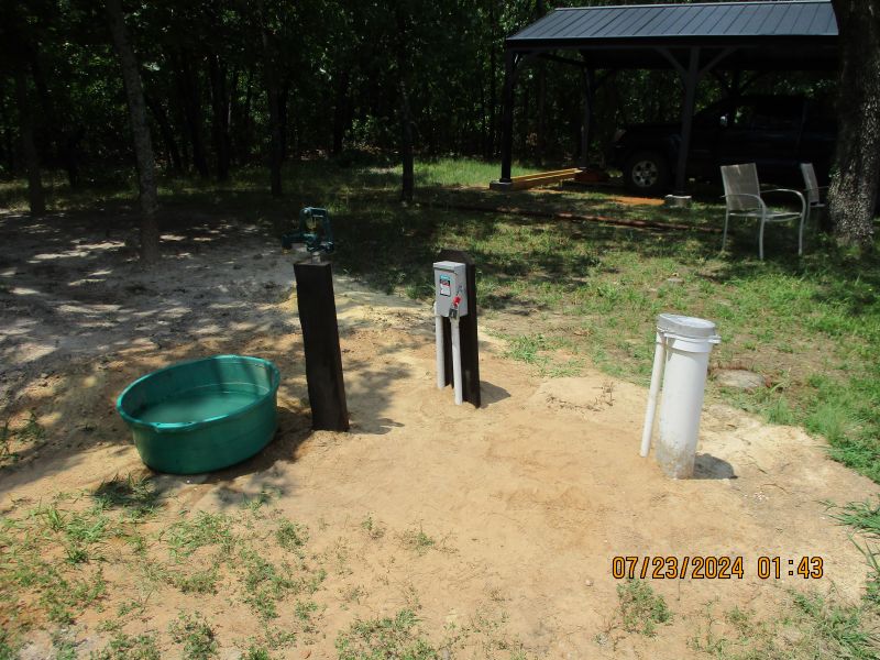

# Posted: 24 Jul 2024 04:57pm
My final out-of-pocket cost was $6900, using my own submersible pump. As shown below, the hook-up is completely manual, not currently tied into the cabin's tank & pressure system (but could be at some point). The bedrock is so close to the surface, that it's almost impossible to dig a ditch below "frost depth". The power is from a dedicated 20 amp circuit. When running the pump & tubing, we felt a static fluid level of about 80' in depth, or 100' of hydrostatic head above the aquifer. (An indicated reservoir pressure of about 45 psi.)
# Posted: 24 Jul 2024 10:03pm
