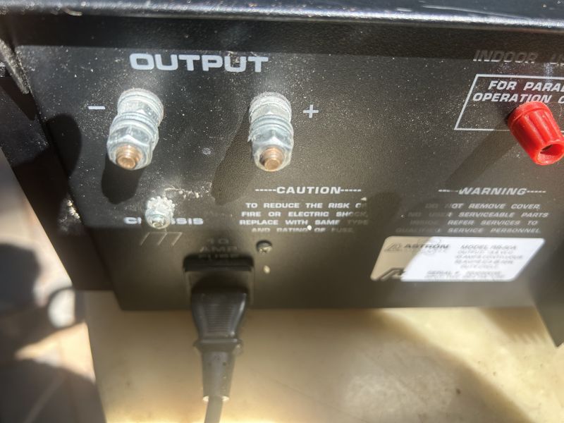

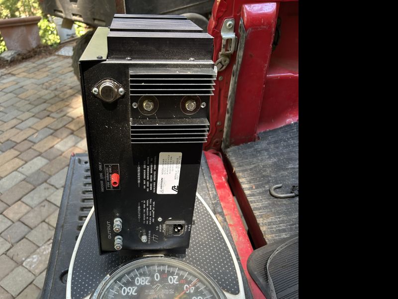

This thread reminded me I have something kicking around in my shed too. Astron, 13.8 vdc, 37 amp. Sucker weighs 40 pounds! Where I got it, original use I have no idea. Never plugged it in, maybe a good Lfp charger?

I plugged it into the inverter, it’s working so far. 13.90v on the VOM unloaded. I’ll try it on a fla then a little 25ah lifepo4 sitting here.
We used to go by a place that gave away handicap stuff my wife could use, they also had a free junk table, that might be where I got it. Or the flea market..

I stuck an fla, the ‘new’ old one I was barking about a month ago, in the golf cart. It’s been sitting on a solar panel but averages a bit over 10v when disconnected. Surprisingly it turned over a few seconds but no start. Then I put this charger behemoth thing on there, volts jumped up to 13 and the cart fired up after two minutes. My amp meter showed a bit over 6 but I don’t think it’s trustable, no sparking at the terms when clipping on. Doesnt amps really depend on what the device (or battery in this case) wants?
I’ll leave that charger on all day and see what happens. Fire extinguisher at the ready,

The DC out on this one has big terminals, easily handle 60 amp. This winter when the solar dies out I’ll swap out a Meanwells and see.

What I have, Astron RS-50A, is not advertised as a battery charger. It is marketed as a ‘Liner Power Supply’
https://www.astroncorp.com/linear-desktop
What I (and gcrank) use now for off solar charging are Meanwell power supplies, carefully monitored of course. In addition I, at least, have the Valence BMS in case it ever came to that.
There may indeed be a difference in the Aston and Meanwell power supplies, and I certainly have no need to try the swap. Thanks for looking into it and please let me know if there is indeed a difference.
