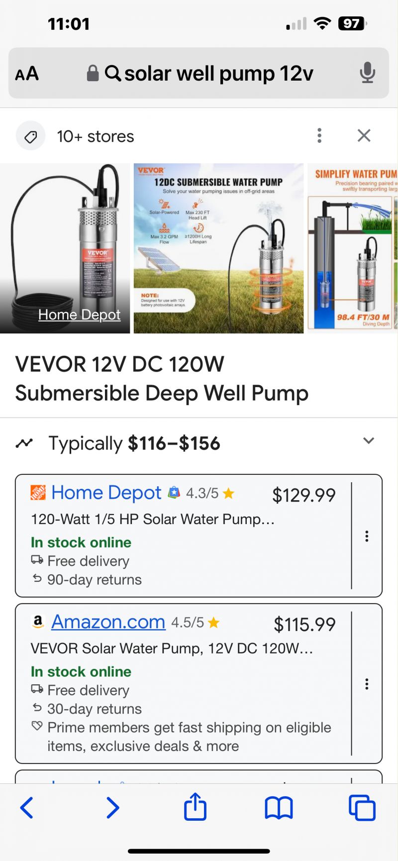

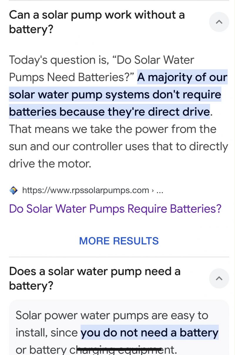

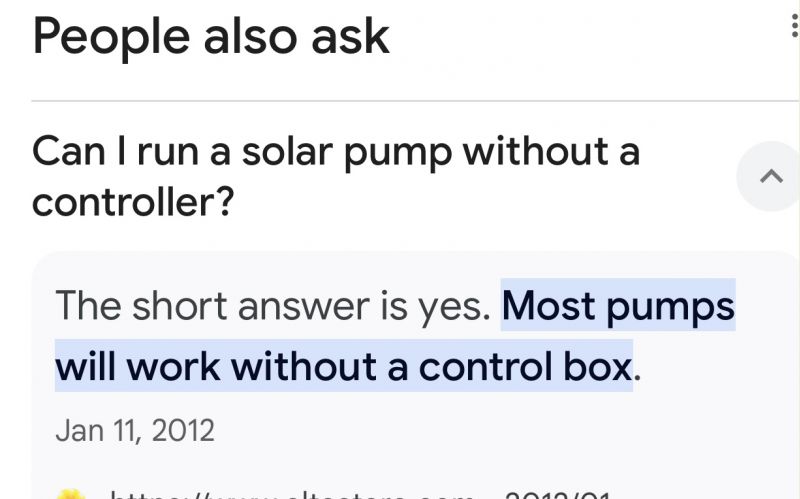

Did a brief bit off researching my solar water pump pipe dream I mentioned earlier. Turns out there are many solar powered well pumps on the market, I guess many live stock troughs are filled that way.
Also some of these setups don’t require batteries, in fact maybe not even a controller! I know nothing about this, but the pump motors must be brushless not to burn up under marginal power.

This one says 230ft lift. Don’t see about battery or controller but that I can deal with.
Starting to sound like a maybe. If my dedicated well shack 220v genny or well pump die might be an option.
