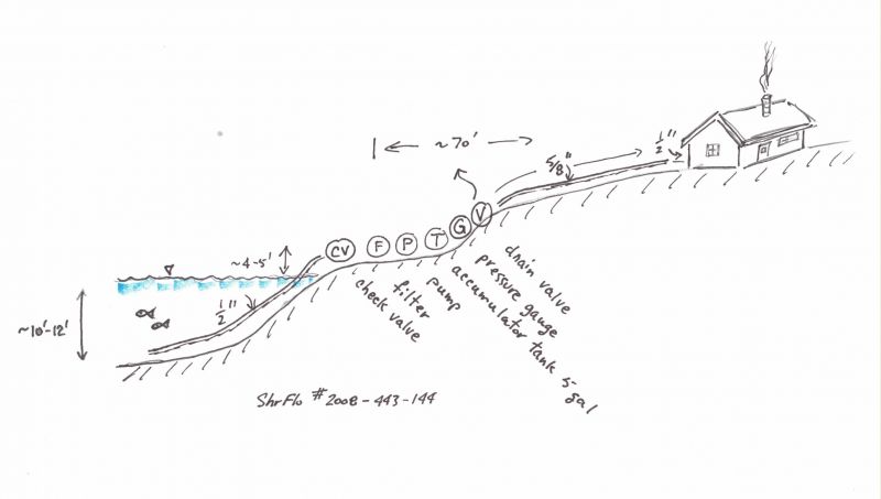

We have an off-grid cabin on a lake in NW Ontario. Our water supply to the cabin has worked well for the past 10 years until this spring when we opened in June.
Pump: ShurFlo 2088-443-144 max 45 psi, cycles on @20 psi off @ 40 psi; powered by dedicated solar and battery; water line intake at 10-12 ft. depth; lift is 4-6 ft. water surface to pump; lift tp cabin ~17 ft.; water line to pump 1/2"; pump to cabin 5/8"; at cabin 1/2" to on demand water heater, kitchen sink, washroom basin and shower. This has been reliable and almost always problem free until now.
Problem: The pump runs and self primes but when pumping out a drain line near the pump, it pulses. When the drain valve is closed it will not pump up to the cabin or pressurize. For now we are using a back-up gravity feed system but it doesn't have the pressure to run the propane water heater. I'm planning to replace the pump perhaps with one that will operate at a higher 30-50 psi range. Any suggestions appreciated. I'll attach a diagram of the set-up.

# Posted: 27 Aug 2024 10:05pm
Here's the diagram of the system.
Tranquil Cabin water system

# Posted: 27 Aug 2024 11:01pm
Diaphram pump? Some times junk can get stuck in the valves of these style pumps making 1 of the few diaphrams not pump. Symptoms are pulsing and weak flow/pressure.

Probably just the pump went kaput, especially if you've been using it for the entire 10 years. Get yourself a nicer, newer ShurFlo, or a Seaflo.....
Or maybe you have a leak near or at the pump to where it's sucking in mainly air. I recently had a hairline crack in a brass fitting that messed with my pump. It appeared in warm weather, too, months after winter had passed.....

The ShurFlo is dedicated to pressurized water deliver from the lake up to the cabin. It has been in service problem free for several years so I know it does the job - until now. Next trip in I'll open it up to see if it is clean or damaged.
The 2088-443-144 I have been using is a 3 chamber, max pressure 45 psi set to range 20-40 psi. I'm wondering if a newer 4 chamber ShurFlo is better. I'm considering a 4008-101-A65 which is max pressure 55 psi. I'm wondering if it comes pre-set to 30-50 psi range.

# Posted: 29 Aug 2024 10:43pm
That's a 3.8gpm unit? I would buy a cheap 5gpm unit just before you go so of you can fix the old one return the new one.
The pressure is adjustable on these via a Philip's screw on the front. In all reality though GPM means more than the difference between 45 to 55psi.
I have used a 12v3gpm pump to pump about 10ft vertically and they really drop off the GPM fast. The cabin I'm building now will use a 120v pump. It gives me more options and less voltage drop under load.
# Posted: 30 Aug 2024 12:14pm
If your pump still runs it’s more than likely something with the diaphragm. Either some crud in it or a tear. I’ve just had to clean mine in the past and it’s back to normal
You can get rebuild kits which might be worth taking with you in case you need to replace the diaphragm

All good replies so thanks. I'm going in next week (20 mi. boat ride) with lumber for another project. I'll take a closer look at the screen filter for cracks or seals and the condition of the diaphragm. I'm off-grid so can only consider 12VDC option. I've got a dedicated solar system for the pump so it also means I have a backup battery if my boat battery goes dead. Saved me a couple of times.
I found a box my brother had given me he bought at a thrift store in Calgary for $5. It contained 2 Shurflo pumps and a bag of parts. Maybe I'll get lucky!
It's amazing the amount of advice and information on the world wide web once you try to solve these problems. Some good, some bad, and some just plain wrong. Also a wide range of prices.
A friend with a similar set-up is using a SHURFLO 4008-101-A65 with good results. It is a 4 chamber pump whereas my 2088 has 3 chambers.
I just called ShurFlo West Coast 1 (800) 854-3218 and spoke with a tech who was good. He said it looks like a cracked or worn out diaphragm. He said the 4008 model would be a good choice if I do need to replace it and confirmed the factory specs:
self priming to 6 ft.
max pressure 55 psi
pump on at 40 psi
set accumulator pressure tank 2 psi below pump on pressure (i.e. 38 psi).
My 2008 model had a range 20 - 40 psi so pressure tank set at 18 psi.
I'll log in down the road to post what ended up working.

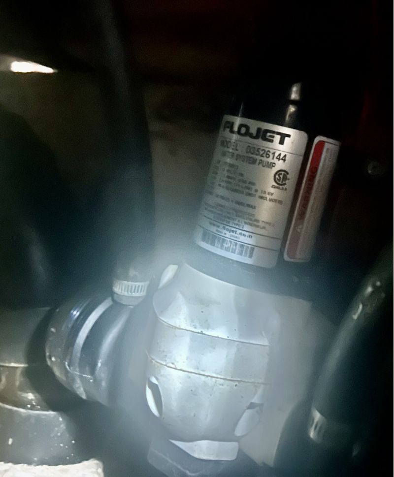

You provoked me to have a look at my pump under the cabin, 10 years of trouble free so far but gets relied on daily. It’s gravity fed so that probably helps. Thought it was a Shurflo but it’s a Flojet, different maker I assume. 12v 50 psi. Maybe I should buy a spare.

# Posted: 1 Sep 2024 01:24am
Flojet is another long time pump maker.

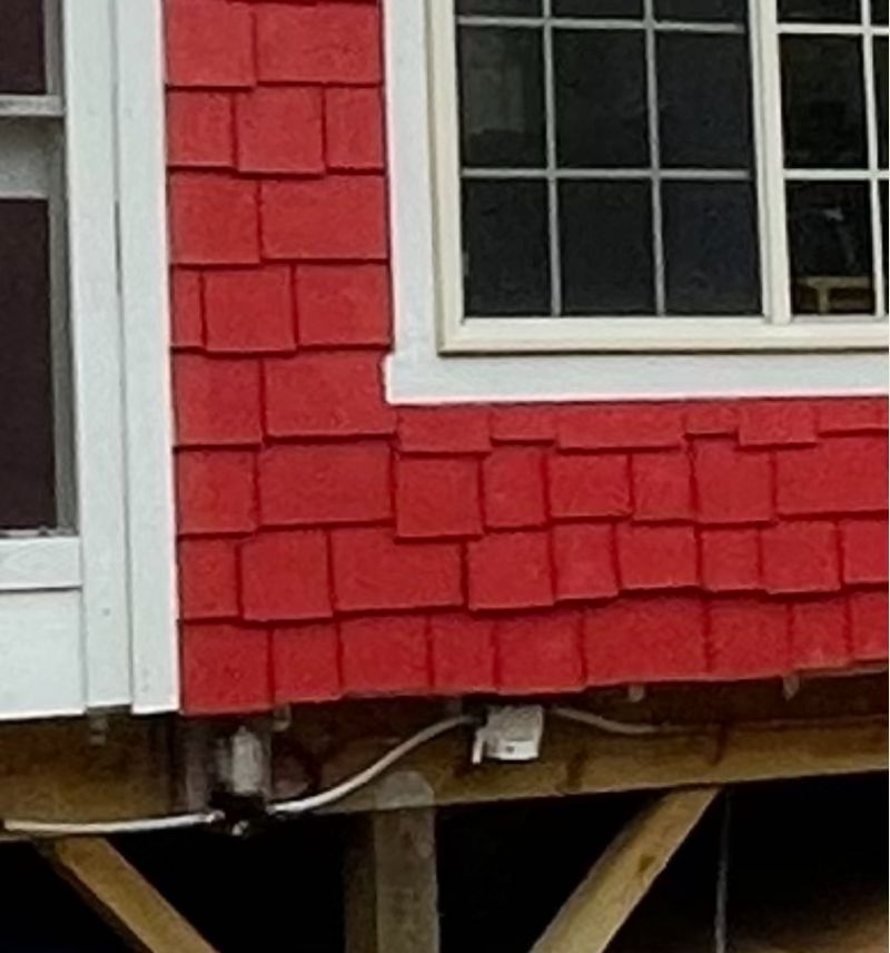

# Posted: 2 Sep 2024 07:00pm - Edited by: Grizzlyman
Mine is screwed to the rimjoist as well but I have it screws through about 3 Inches of pink foam. Seems to work well- similar noise as others. I can hear it but not really. Also think it’s important to hear to know when running or if there’s a leak. We have a seperate pump switch and always turn off at night as well.
Not the best photo but can see how the pump is attached through the foam.
# Posted: 2 Sep 2024 07:15pm
