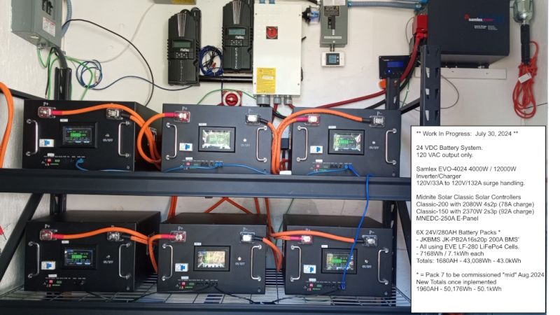

PS: This is what I did this past few weeks... Still waiting on parts for Pack 7 (rail strike delayed).
This is 24V in the same cases I mention above.
WIP Steve's Battery Bank
# Posted: 1 Sep 2024 02:31pm
what does that one big weigh?
There are a few factors. Cell weight, casing & parts within.
My 24V/280AH Packs with case, BMS and everything just tickle 50 Kg / 110 lbs +/- a bit. probably closer to 53kg actually.
