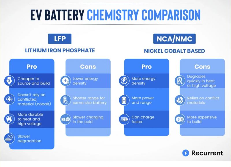

On another note, my friend Mitch who just those LFPs in his cabin, sent me this article on Li battery types. I had no idea LFPs were being used in E cars.
https://www.recurrentauto.com/research/lfp-battery-in-your-next-ev-tesla-and-others-s ay-yes
