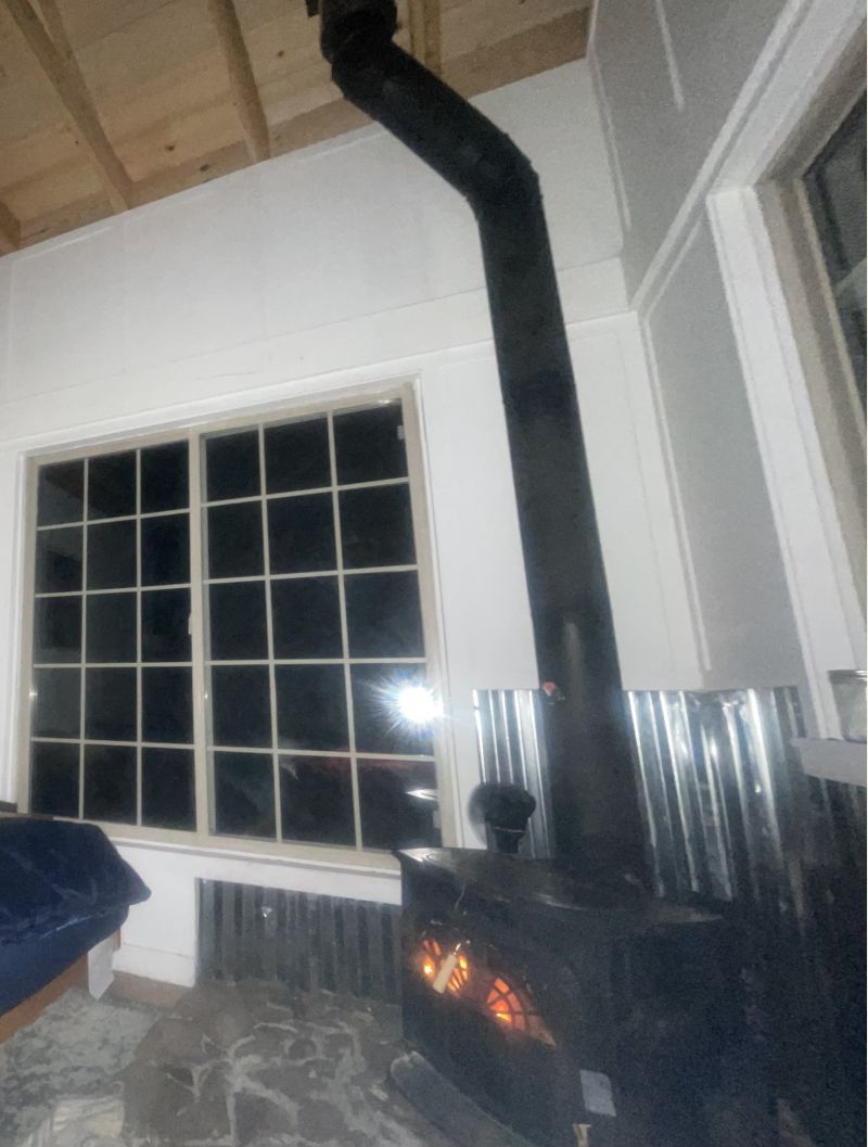

My stove pipe has a jog in it- 45* for about 4 ft, then vertical again.
What’s the best Way to clean this. I’m really hoping the word ”disassemble” doesn’t show up here. Lol

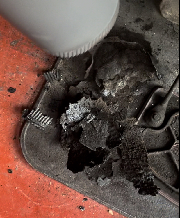

When I bought this stove last year I disassembled it for the guy. The amount of creosote that came out as I disassembled the pipe for him was staggering. Huge flaky chunks. Probably enough in their pipe to loosely fill up 1/2 5 gallon bucket.
Not the best picture but here’s just a little bit from the pipe section connected to the stove itself.
# Posted: 24 Sep 2024 02:06am
Ohhhh
Might be my old inefficient antique store burned up the stack way more than a nice VC with great air control.
And we had pine to mix with oak for start up and mostly oak thereafter. Never saw stuff like that come out on a cleaning.....
# Posted: 24 Sep 2024 01:56pm
yep. Shiny black corn flakes. Stage two creosote. Better than stage three, when it is more like tar that melted on the pipe surface.
My chimneys have usually been small flakes or powdery dust.
