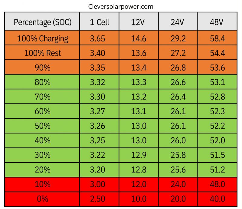

  The chart I've gone by shows 52.8v as 70% and 52.3v as 60%  It shows 51.6v to be just over 30%  perhaps I'm looking at the wrong chart?  Maybe I'm in way better shape than I think! (Chart attached)

  The 'charts' are notoriously wrong, even for LA, but more so with LFP because the working voltage band is So narrow and needs to be metered to a min. of 2 decimal places.
# Posted: 5 Nov 2024 04:08pm
  That chart is based on "Allowable Voltage Range" which is not the Working Voltage Range for LFP (3.000-3.400 volts per cell).
  You are staying well within the working range and causing zero stress by doing so. If all your packs are individually at the same voltage (2 decimal accurate) then all is well.
