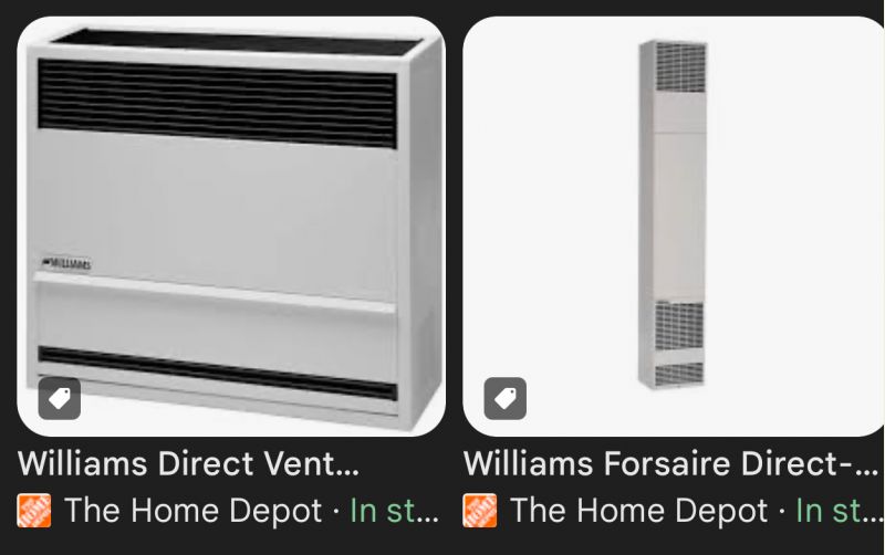

# Posted: 29 Dec 2024 09:18am
My Williams is the short wide one. Wish it was the tall narrow one, cabin has more room going up than sideways.
There must be many other brands of used stuff out there. Mine came off Craigslist.
# Posted: 29 Dec 2024 06:15pm
The tall skinny ones are usually designed to fit between two 16"OC studs in the wall. Some, like the Williams, IIRC, can also be mounted on the wall face and protruding out into the room. They require 120 VAC as the ones I have seen have a blower than blows air out the bottom vent as it draws it in the top vent. Years ago I did see a tall model that would work with no fan; don't recall the name. If you are looking for one ascertain if it works without the blower as many do not; also most will be 120 VAC and not DC unless it was for an RV.
# Posted: 29 Dec 2024 09:27pm
Ok good, glad I ended up with the other one. Uses no juice. It does have a spot for a fan. I had a usb fan in there for awhile, never bothered with it.

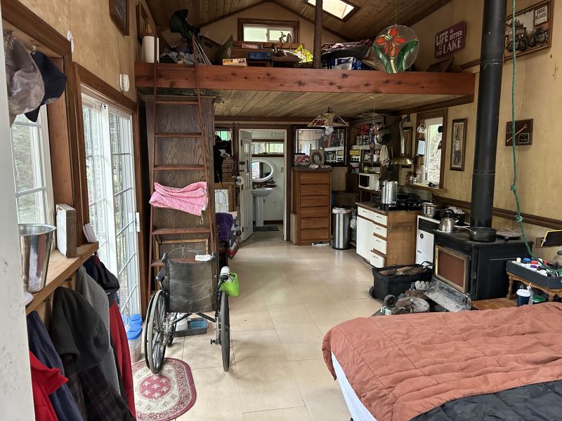

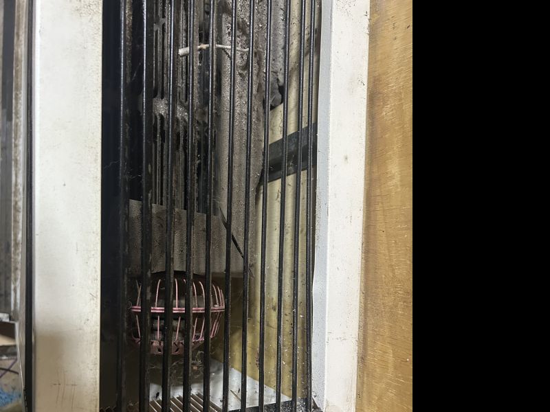

Speak of the devil.. Got to the cabin today after several grid days, 42F inside and out. After firing up the wood stove for awhile, still cold, so I fired up the Williams Lp wall heater. Both still going now, 69 and climbing, 48 outside. Also fired up that USB fan I put inside the Williams long ago, see photo.

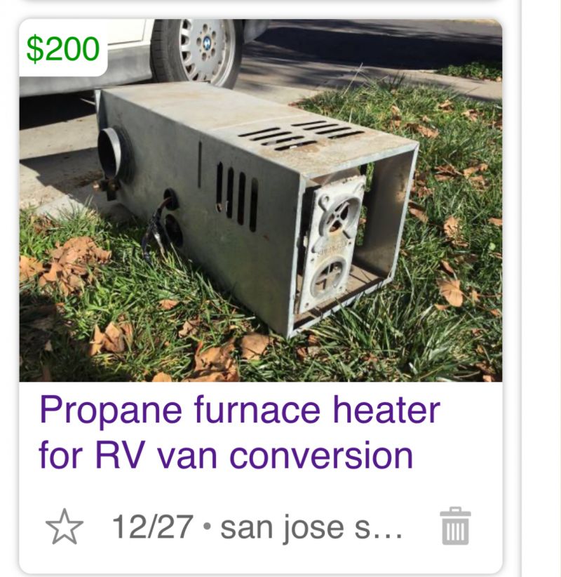

Also saw this on Craigslist. San Jose is way south for me but that would do you. Maybe an RV recycle yard?
# Posted: 1 Jan 2025 06:39pm
RV furnaces have always seemed to really suck up the watts. They are nice for being able to distribute air through the ducts. The one fan motor usually spins bother sir circulation fan and the combustion air fan. They don't work without power.
Does the advt state how many BTU's?
They have an electronic control board. Some are pricey but there are often aftermarket boards available for less.
# Posted: 1 Jan 2025 06:53pm
There are some pictures in the add of the data plate but I can’t make it out on my phone. Here’s a link.
https://sfbay.craigslist.org/sby/pts/d/san-jose-propane-furnace-heater-for-rv/7807372 907.html
# Posted: 1 Jan 2025 08:08pm
We had the typical 'Atwood' rv furnace in our bought new 2008? Aliner, generally only used it to warm up, not run for endless hours. When it ran it made a Lot of noise and used a Lot of 12vdc power; wasnt easy on propane either but that is an easy math calc knowing the Btu's output.
So, with not a lot of run hours the 'board' went out.... aggravating and expensive. I did the research and bought a well regarded aftermarket board (the oem replacement will fail just like the first one)
Short of it is, Im glad to be rid of it.
