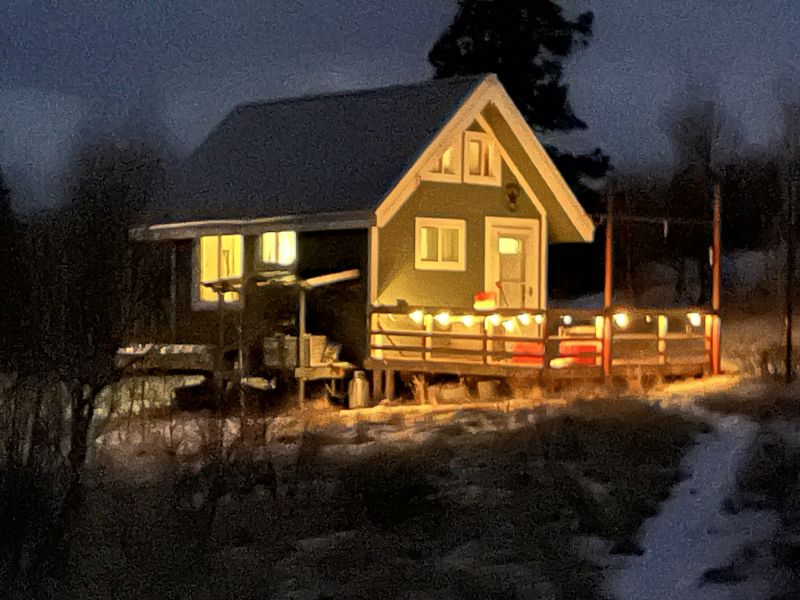

The cabin is 12x16 with a loft. Colorado location.
I currently have an Empire propane heater, 10,000 btu’s. Last trip the daytime temps averaged about 40/45. Nighttime was about 15/20. Enjoyed the heck out of sunny days, no wind and relatively mild temps.

Frank, what a great looking cabin and photo! I’m a wood burner but it won’t be long before gcrank and other LP guys chime in. Just wanted to give you a bump.

I initially went out to photo the last full moon. They are never as good as the real thing. Turned around and said, Dang!
Only one 60 watt bulb inside. Thinking the motion sensor light is still on, on the deck.
Cannot wait until longer sunny days are back.
